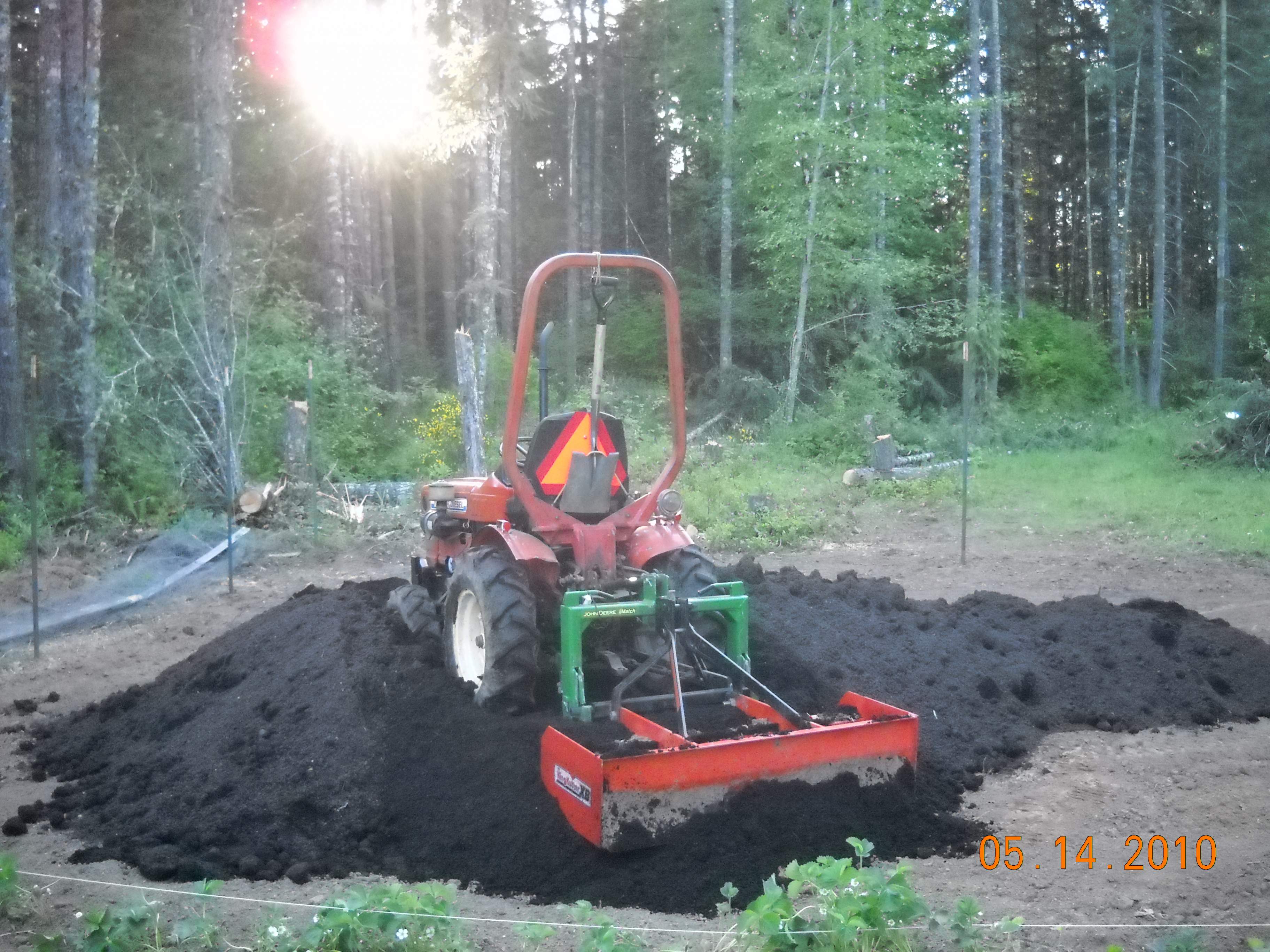

i have both and use my boxblade WAY more than my angle blade. the boxblade is excelent for moving a lot of dirt fast. If you plan on excavating and filling areas in, get a boxblade.
