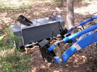

I just bought a 2002 TC35. While shopping around a lot of the new loaders offer a quick attach option. Can an older unit like mine be converted to this feature?

There are some manufacturers that sell "universal" quick attach parts that can be used to modify an existing loader. Some cutting and welding is required. Sorry, I don't have any links right now, I was looking at them several weeks ago, but I didn't save any links. Search for "skid steer" "quick attach", you'll find them.

You can buy a quick attach plate for your loader arms from NH for around $400 or less. The bucket will need the old brackets cut off and a new quick attach plate welded on. You can buy these plates on ebay or probably right from your NH dealer. The plate should be around $100. If it's a lot more, it's a ripoff. A welding shop can do the removal and weld-on for around $150. So expect to be out about $650 for the entire process. Well worth it...I don't know anything that I like better about my tractor than that QA loader.

like this .. note the old brackets sitting on top .....cut them off then weld the QA plate on ... and buy the pin on adapter for the tractor side

monte -- bought the tractor side of the QA from a dealer for about $400 ... the weld on plate I ordered from online for around $125...don't have that website for ya right now -- but do a search and you'll find 'em.....Best money I ever spent. Entire QA bucket was about $600 ....but then what do you do with the old one? Better choice for me was just to modify the old one.
