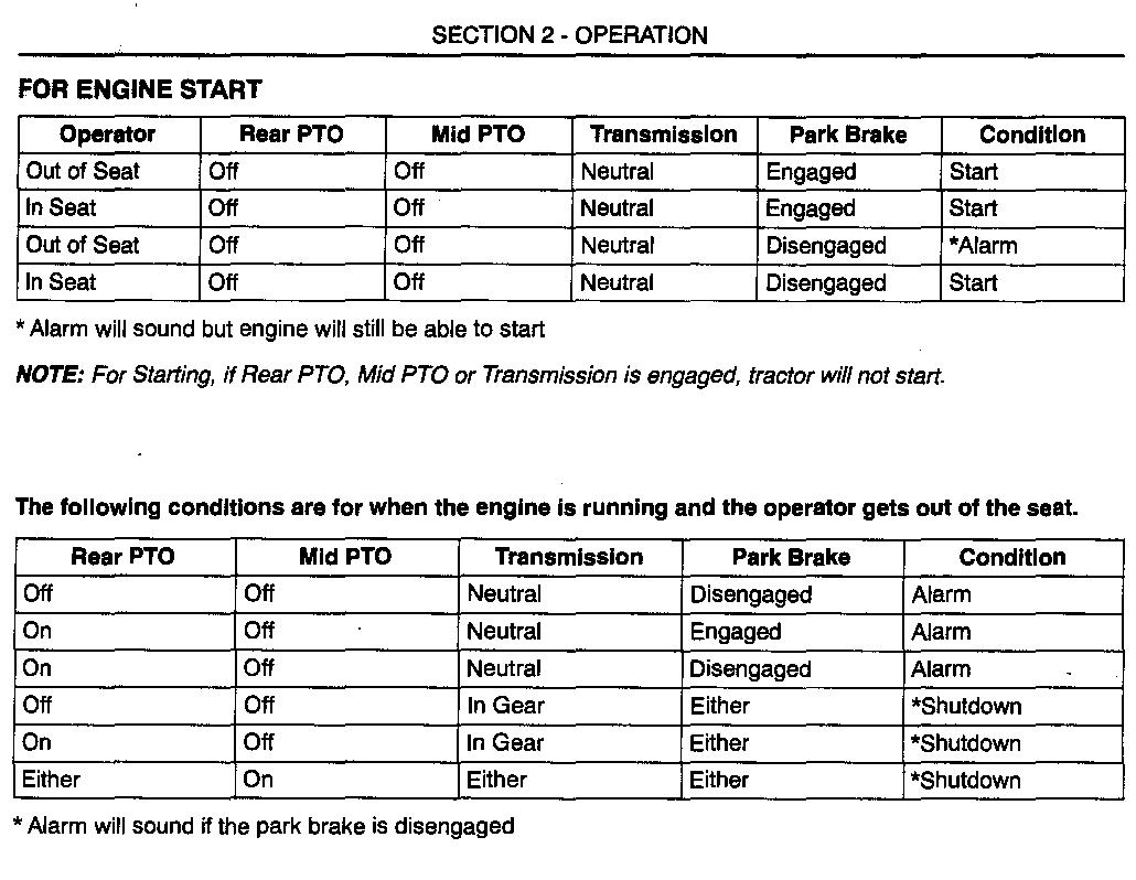

I have an new TC34da with 19 hours on it that has suddenly developed a problem with the mid pto system. Today while dismounting the tractor while the engine was running, transmission in neutral, and parking brake set the enigine shut down like it would if the transmission had been left in gear.
I got back in seat and checked if gear was in neutral. Everything looked correct for engine to remain running without operator in seat but no dice . Engine would shut off every time so I checked instrument cluster to see if PTO light was lit. No light lit except parking brake.
I asked my son to check rotation of Rear pto shaft as I could not see it from seat. Rear pto shaft only turning when lever moved to energize. PTO light goes on and off and it should. Just for the heck of it I asked himto check mid- pto shaft.
Here lies the issue, the lever is in the off position and the pto light is not on but the shaft is turning and I cannot get it to disengage no matter how hard I pull back on lever.
Appearently the tractor senses the mid pto is engaged even though I have no pto light lit and this causes the tractor to shut down just as if the pto light was energized.
Has anyone ever experienced this issue with this model or another class II boomer? This is quite puzzling because as today I have never even used this lever before.

I checked the linkage and looks to be OK. I noticed the linkage is moving but the lever at the mid pto case does not seem to be moving up and down which seems to indicate that something is jammed inside the case. This is all very strange as the tractor and safety switches were functioning correctly this morning at 10:00 am, parked tractor and restarted about an hour later. MID pto had not been used and for that matter has never been used. Tractor just started shutting off when it shouldn't be.
According to the owners manual the tractor should not start with mid pto engaged, whether in seat or not. I do not have a pto light on in the dash but tractor will not start unless I am in seat and then will shut down if I leave seat. The manual shows only two conditions that will shut down tractor if you exit seat, transmission not in neutral and mid-pto engaged. I believe I have to pay my New Holland dealer a visit Tuesday.

My DX29 will also shut down if the brake isn't set and the light for that operation isn't on. I have had some issues with the little lever that sets the brake and turns on the light. Did you just forget to mention that above, or are you overlooking the need to have the brake set when you get off the tractor if you want it to keep running
Parking brake was set as mentioned in my first post. On the TC34DA you do not have to set parking brake to dis-mount from seat as long as transmission is in neutral and the mid-pto is not engaged. Engine will keep running but you will get an audible alarm reminding you that brake is not set, you can even exit tractor with rear pto engaged without parking brake set and engine will still run, just audible alarm sounds.

Below are conditions which must be in effect for starting tractor and for exiting tractor if engine is running.
