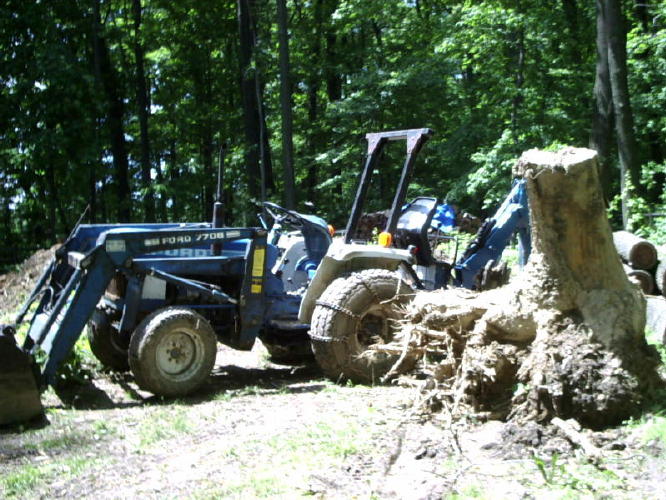

I looked at the New Holland/Rhino backhoe at the dealer today, and like the mount that they use. Looks easier to hook up than what I have now. I do like the Woods 7500 machine, I've used it to dig out tree stumps as big as my tractor.. see the attachment, but have thought about selling or trading the Woods for the NH/Rhino. Does anyone know how they compare? They look very similar to me, but looks don't tell you much.
