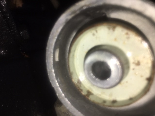

TBNers - I am having a devil of a time finding a fuel filter that fits my tractor. Everyone I have received, the hole in the top center is too small. Anyone else ever encounter this problem?
The latest one I tried was a CNH Part number SBA360720130. I ordered this a while back and I am just getting around to installing. This part number has been superseded, but I suspect the new part has the same dimensions...which I believe is a 13mm opening.
Thanks!
Gorm.

As a New Holland dealership employee for the last 20 years I know there have been no widespread or even isolated problems with fitment regarding that particular filter regardless of the part number it is sold as. The filter and filter head predate your tractor by at least a decade. Is the o ring on the nipple in the filter head swelled up or not dimensionally correct?

No, I didn't see the o-ring. Attached is a picture....

Well - I finally figured it out. Look closely at the picture, that's the old filter's metal end cap! How I missed that, I don't know! Oh well, live and learn...Thanks again Rick for confirming it was not a filter-sizing issue.

That explains why I couldn’t figure out what the *#@& your photo was supposed to be!
