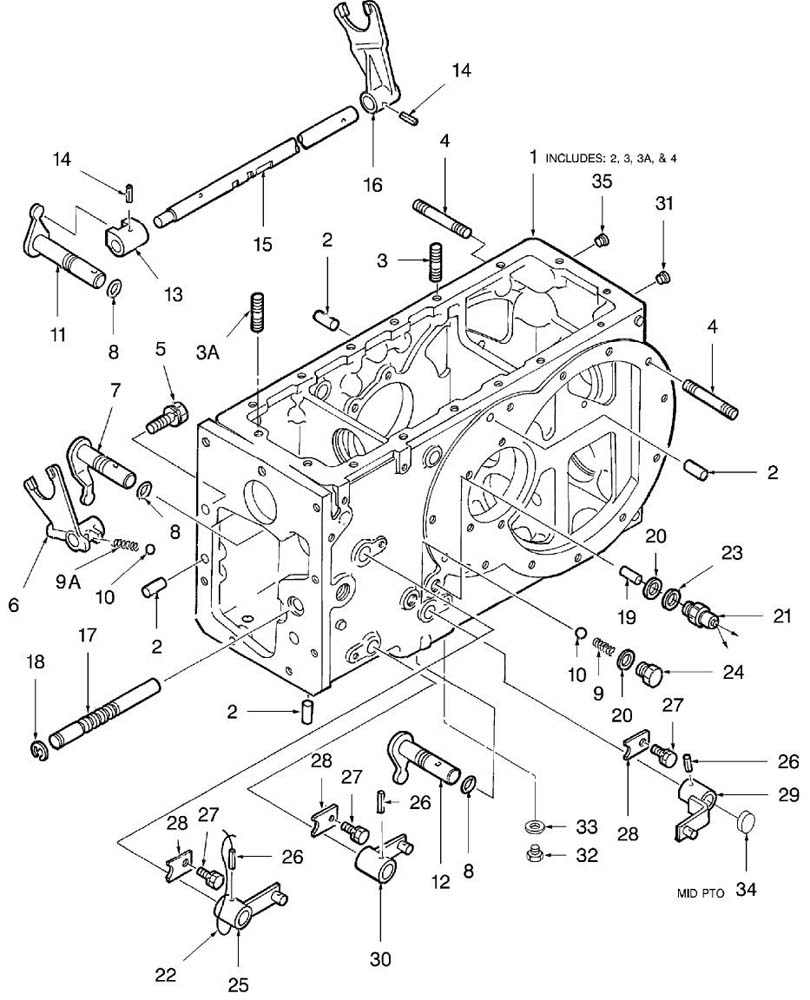

I have been having some problems when trying to engage my rear PTO.
It seems like the shifting lever just doesn't want or can't move the far enough to complete the PTO gear engagement
I have removed the shifting linkage from the gear box. The linkage moves through it's complete range of motion without binding or resistance. I have adjusted the linkage a couple of times. Each time after adjustment the shifting seems to work for a few shifts and then seems to just quit moving the gear box shifting lever far enough. It almost seems like the shifting lever on the fender ( top portion) is flexing or bending. I have looked at the linkage and it doesn't appear to be bent or slipping.
To prove that the rear PTO will engage, I can very easily shift into PTO mode using a pair of vice grips on the shaft out of the gear box.
I would like to know if anyone else with this or similar make and model New Holland has had or is presently having this type of shifting problem on their rear PTO.

This is an old subject, but I have had the same problem with my rear PTO lever bending for 4 years. I just endured until today. I was at the New Holland dealer and purchased a new spring for the ball detent which is down on the side of the case in close proximity to the mid PTO engagement. The new spring was a little smaller in diameter and not so strong and it completely solved my problem. I had even taken my rear lever off and reinforced it and I still managed to bend it again. The lever was well lubricated and that wasn't my problem.
I hope this helps anybody that has the same problem as I had.

The New Holland part number for the spring I purchased and intalled is 398210280. It cost $1.26 if I recall correctly.
The New Holland parts illustration that shows the spring I am talking about is below. It is part number 9 in the illustration and it shows where it is located. When you remove the plug with the spring behind it, no hydraulic fluid will come out.
