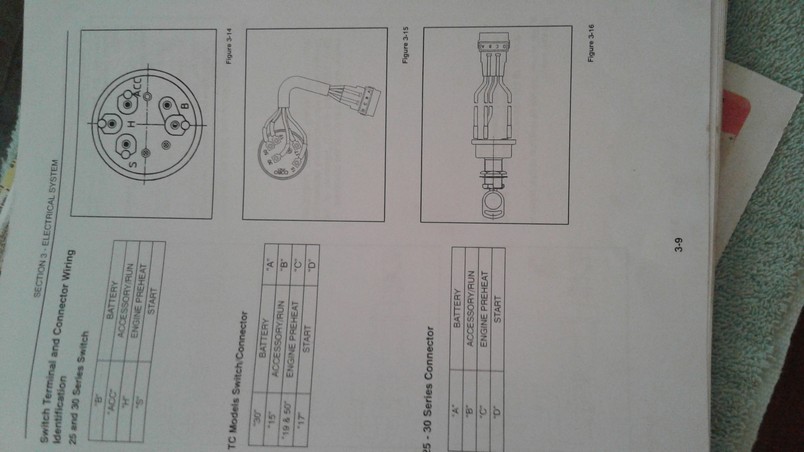

I need to replace my ignition switch and have read that the OEM switches are not as good as aftermarket switches. I bought a good 4-position switch from NAPA but cannot figure out how to connect the 4 wires from the harness to the switch. Apparently, I'm not functionally literate in "wiring diagram". Since the wires immediately disappear into the main harness, following them doesn't work either. I could get the instrument panel to illuminate, the glow plug light to light and go out indicating that (I hope) the glow plug relay was functioning, and the starter to turn, but the engine wouldn't fire. Fuses are all good. Any help out there?

Rog, that's exactly what I was looking for though I think I tried that and it would crank but not start (had to abandon the ignition project to fix the hot water line in the basement...haven't used words like that since I was a tanker in the Army). I'll try it again and post the results.

I replaced my defective switch with a generic one from the FLAPS.. works fine. Just had to cut the OE end off and crimp on some new terminal rings..

Thx Ford850, the Case link was exactly correct. Wired it up, cranked it and drove it back out of the woods. Good thing since it's now snowing...

From a page in the service manual:
