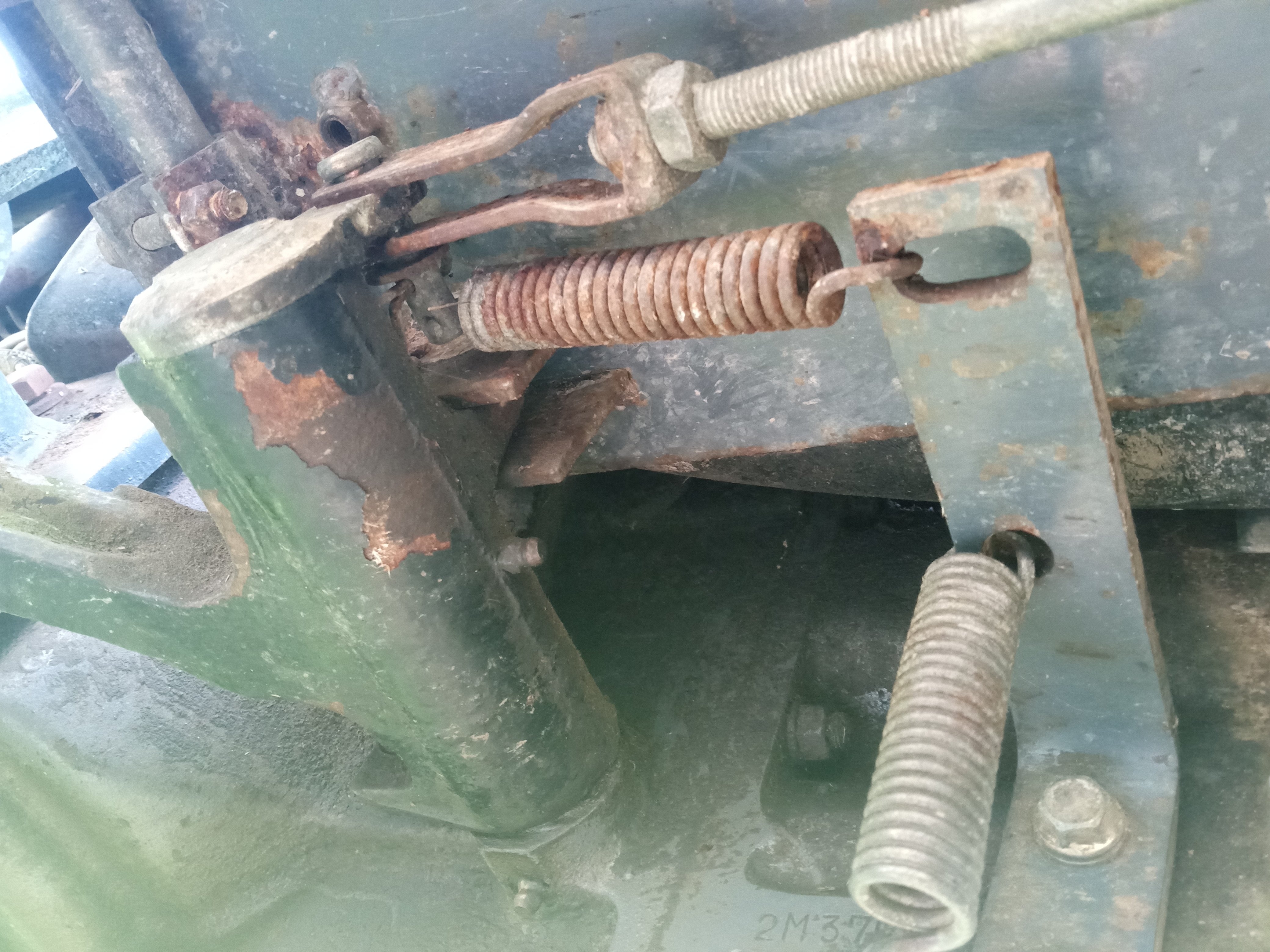

TC33D NOT HST(1999-2001). My clutch pedal will press to the floor without disengaging and with little to no resistance. Trying to find a parts diagram so I can see what is what. I know I have a broken return spring for the pedal, but with the pedal NOT disengaging when depressed, my best guess is clutch plate is stuck inside. I am getting movement on the lever shown in pictures. Any help/info is appreciated. Repair/service manual etc.

I’ve had success driving holding the pedal down and breaking the disc free.
Sometimes this meant starting as rolling down an incline.
Some will block the clutch pedal down if equipment stored any length.
