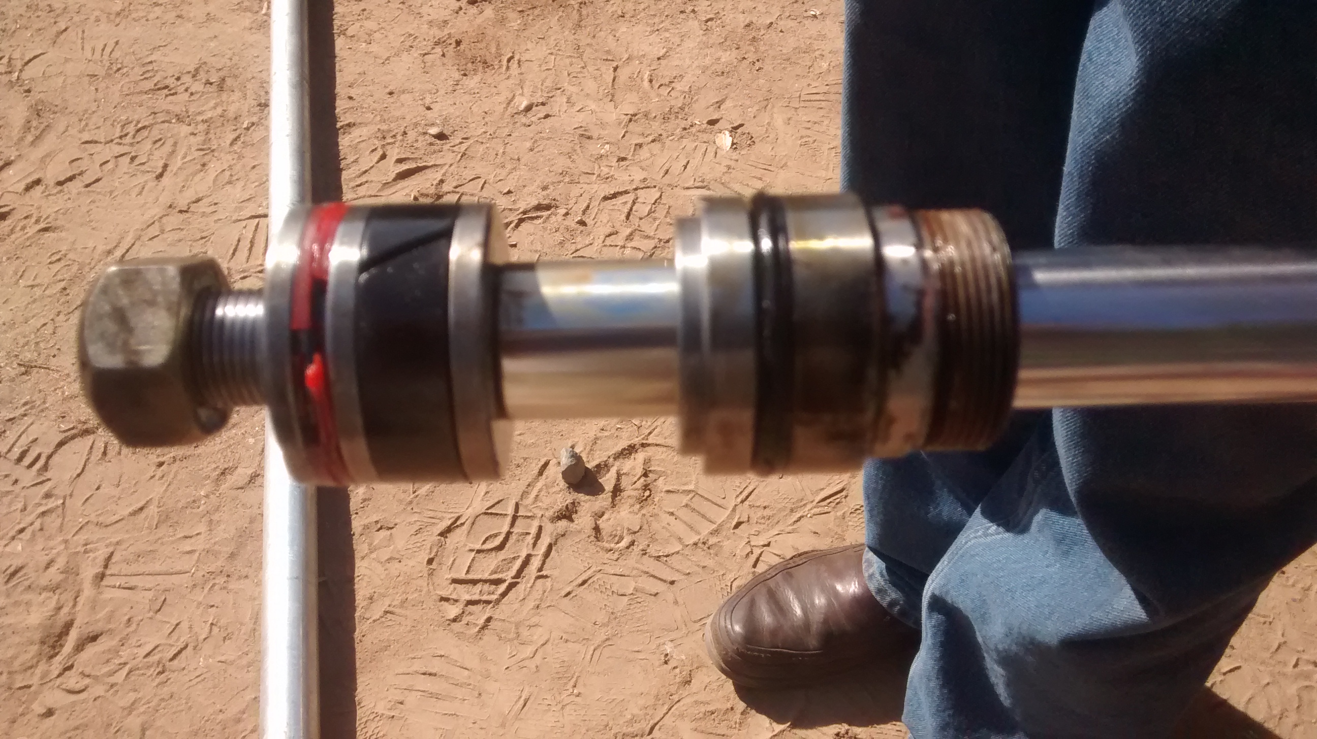

There are surely other ways, but DL is correct. You can also mechanically extend the cylinder and hold pressure on the fully extended rod while you unthread the spanner nut with a punch and hammer. But it is disassembled in the manner DL describes.
   / TC33D BUCKET CYLINDER #10

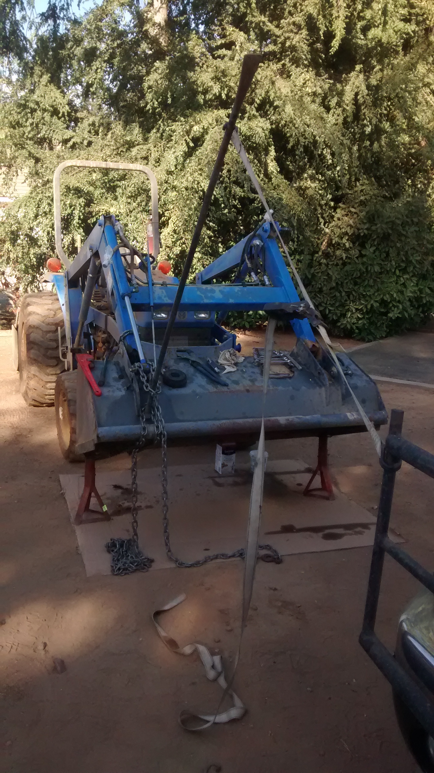

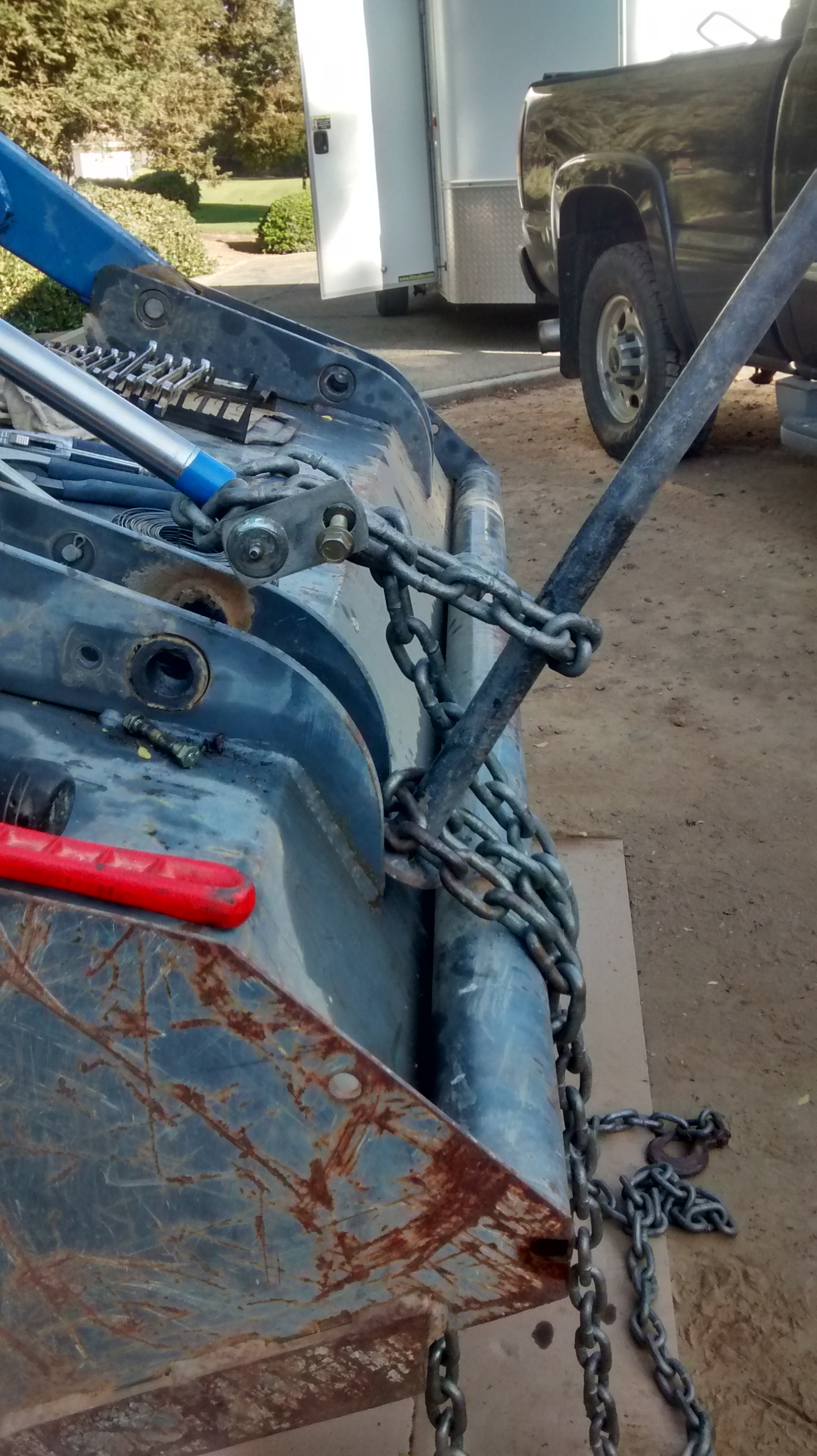

Thank-you All. I will give these ideas a try today. I wish I knew of a hydraulics shop in Fresno, CA with as reasonable rates as the one Spitter has in Blairtown.
