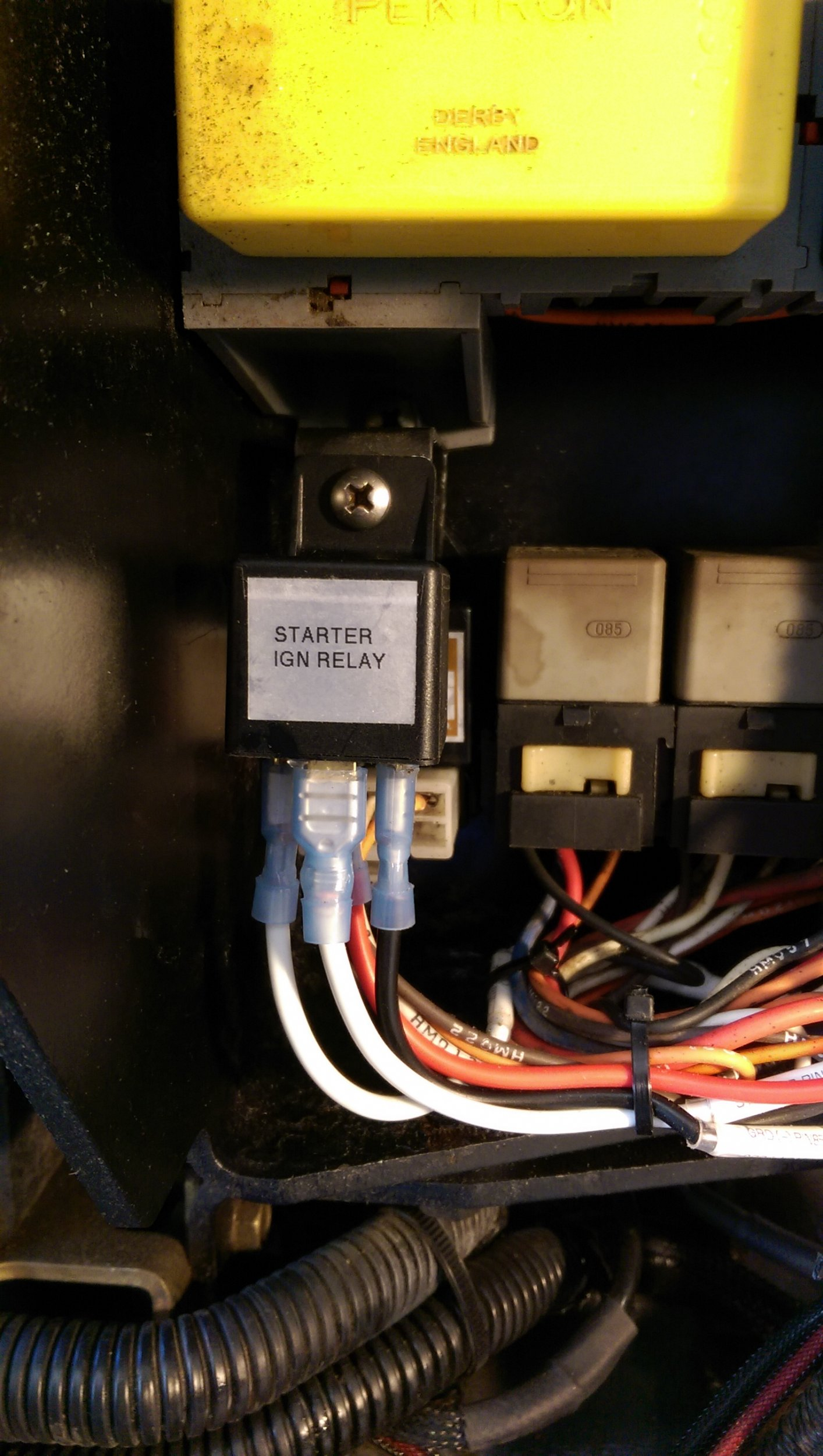

So the TC series have issues with the starting circuit, especially as they get older & this can definitely cause the issue you are describing.
You can modify the current wiring & add a dedicated relay for supplying direct power to the starter solenoid via the same circuits. I did this on our TC40D & it made a big difference for our machine.
Basically over time the connections get dirty, contact corrode, ect & there ends up being to much resistance in the circuit to provide full voltage to the solenoid . Adding the dedicated relay eliminates that issue while keeping all other functions of the circuit intact. This may be the issue...
Here is a pic of the relay I added...
Here is the PDF I used... (didn't save the original post... but credit goes to the OP)
  • Starting Circuit Modification.pdf
