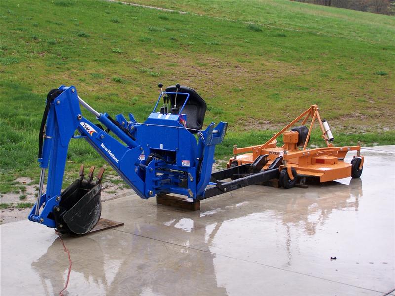

Although my TC24DA is a little smaller than your 33, I thought I would comment on the backhoe. When we bought this one I paid $6200.00 a little over a year ago. I had the chance to see a Woods BH next to the NH and I was not impressed at all. I generally am very happy with Woods products but chose the NH756C hoe instead.
Here's a pic of it dismounted.

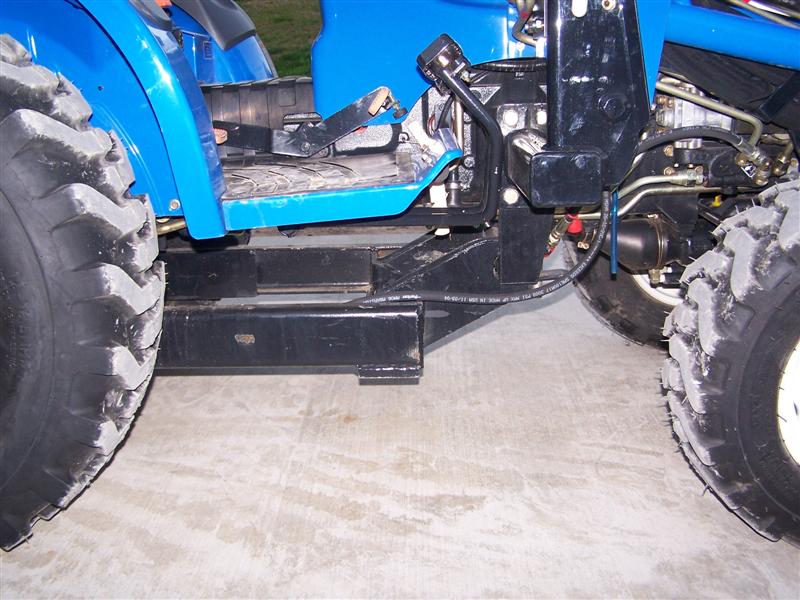

   / TC33D - Backhoe questions #5
Front subframe detail. I like the fact that nothing really stays on the tractor when the BH is off.
