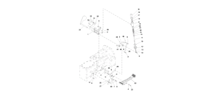

My TC31DA started creeping last week when the pedal is in the neutral position. I have read the previous posts but I have been unable to figure out how to adjust my machine. I have attached an image of the pedal and linkage.
Thanks

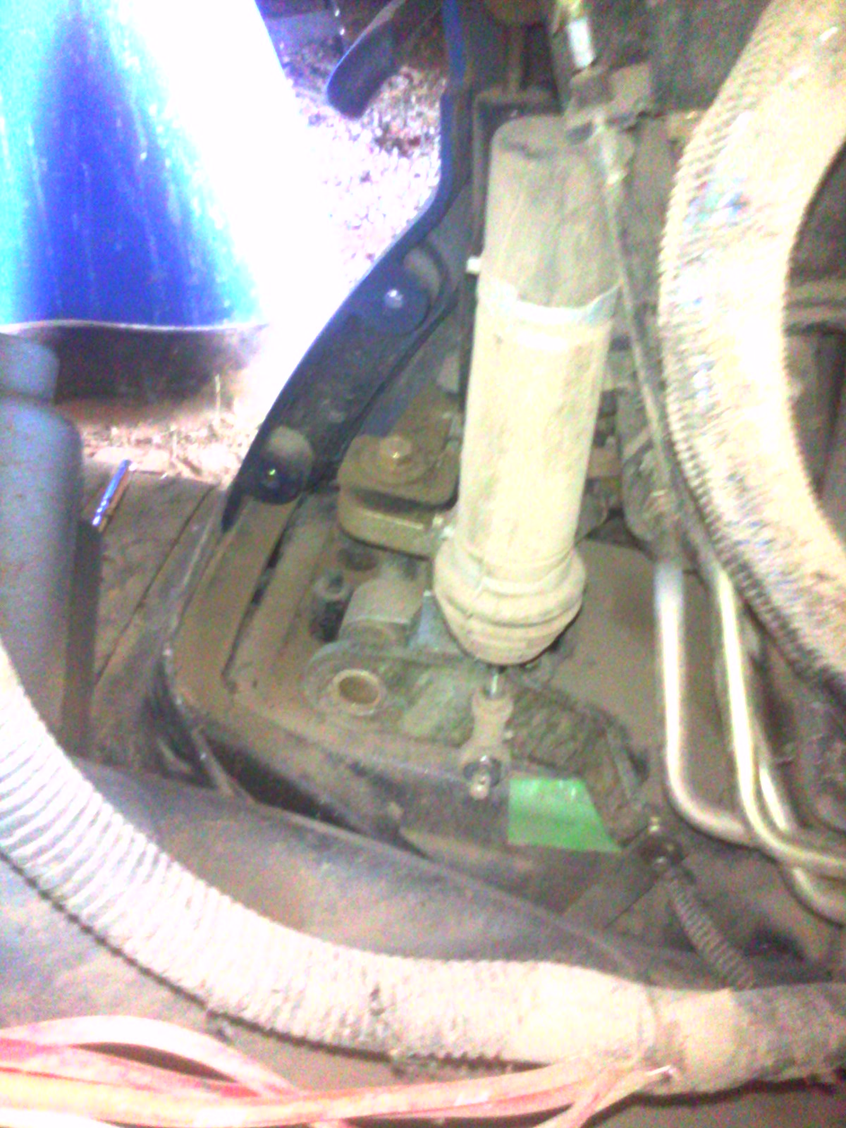

Well, I did the repair this weekend along with changing all the fluids and things went well. Adjusting the pedal was easy and thanks to the members you sent me instructions.
After removing the cowl the shock is clearly visible. I just used wrench and rotated the shaft to adjust the pedal. Very easy.
