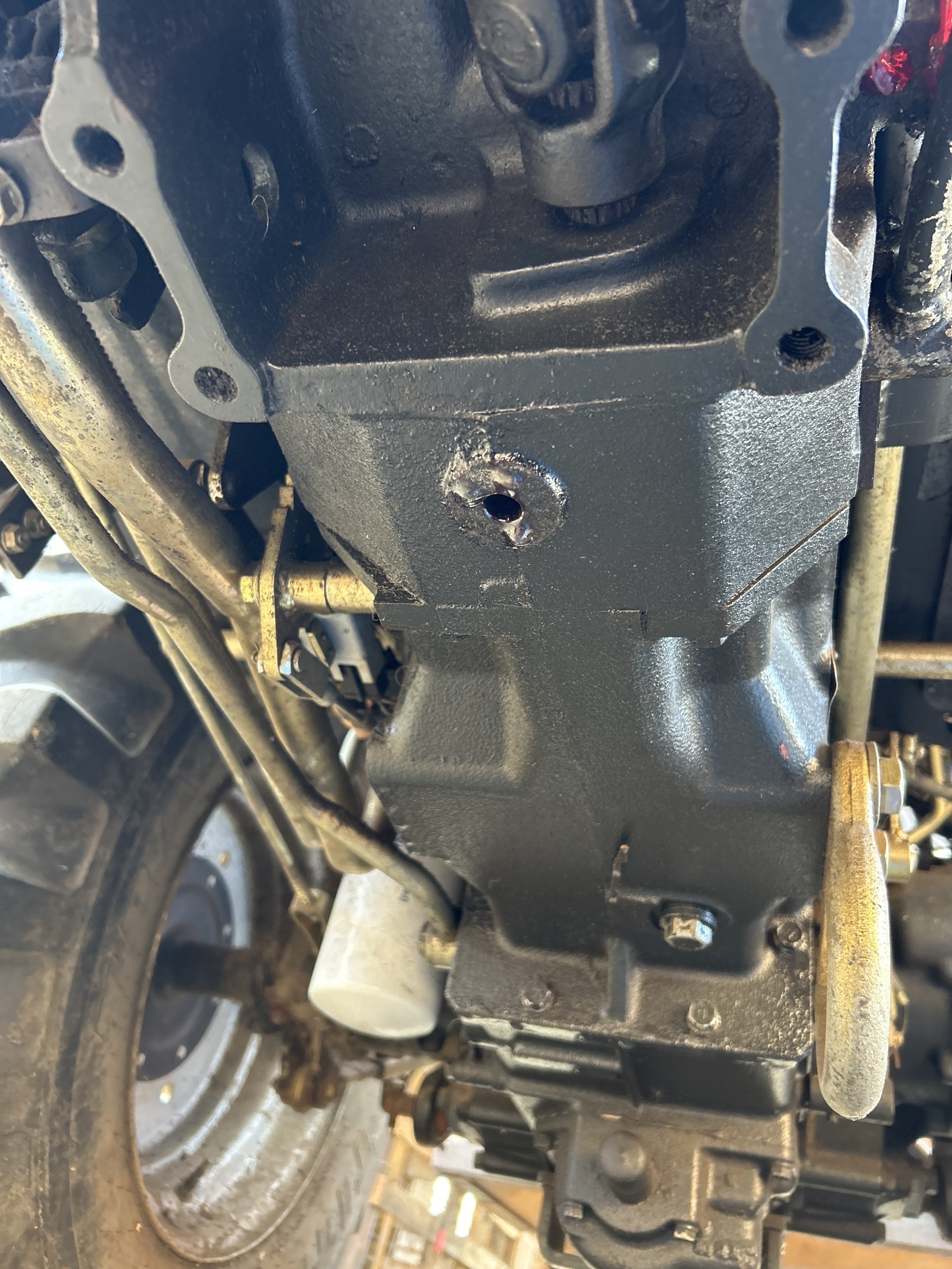

Hey everyone, I am new to this form and appreciate any help anyone has to offer. I have a new to me case DX 31 which is identical to the New Holland TC 31 and I have a hydraulic leak from an open hole underneath and I can’t figure out why it is leaking. Any help is greatly appreciate!
   / TC31 / DX31
#2
Hey everyone, I am new to this form and appreciate any help anyone has to offer. I have a new to me case DX 31 which is identical to the New Holland TC 31 and I have a hydraulic leak from an open hole underneath and I can’t figure out why it is leaking. Any help is greatly appreciate!View attachment 1839161
One other thing it only seems to leak when it’s running.
   / TC31 / DX31 #3
If that's the clutch housing/bell housing, then it must be the transmission input shaft seal.
It requires splitting the tractor in half to change that seal. While there, it may be a good idea to change the rear main seal on the engine.
   / TC31 / DX31
Awesome not what I wanted to hear. Ughh decisions decisions. The tractor runs and operates great but I’ll bet that’s why the previous owner traded it in. It only has 650hrs.
