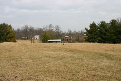

Our new property is mostly flat with gentle slopes. It's all grass and has been regularly bushhogged by the previous owner. Thanks for the info.
I'm trying to decide on the best combination of tractor/mower size for our new 12 acre property. I really like the class III boomers but the $ and maneuverability have me checking out the class II machines and there capabilities as well.

If you buy that TC30 and put a 84" RFM behind it, you are essentially setting up a situation where you will get satisfactory results ONLY when there are perfect conditions. I think that's a risky way to go. Look at normal riding mowers. Even the ones with 25 hp only have a 52"-54" deck. There's a reason for that in my opinion. Why not drop back to a 72" RFM and give yourself a little more "buffer" room, or ideally, drop back to 60" and have enough power to mow anything you want in any condition? Otherwise, I'd go to a Class III with big fat turfs. /forums/images/graemlins/cool.gif
Buying a combination that will work only in the perfect condition is not something I'd recommend. /forums/images/graemlins/smirk.gif
