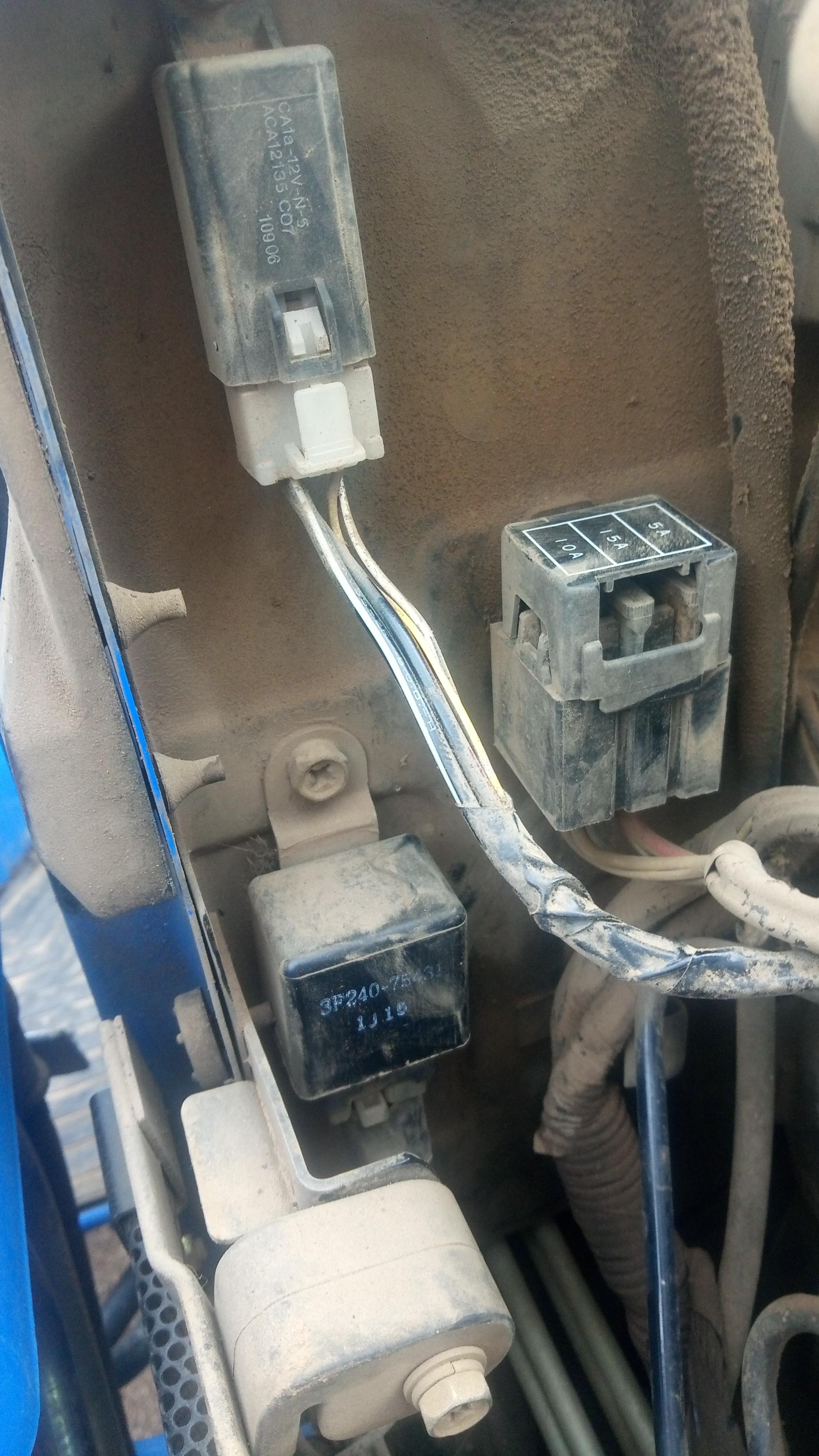

The fuse panel should be on the firewall to the left of the fuel fill tube , ( looking at picture #3 ) . Personally , I would look for a gauge / sending unit kit and install . I did this on my TC30 when the gauge quit working . At that time , a new gauge was easily over $200 just for the gauge . Think I spent like $28 for kit and $6 shipping on J.C. Whitney . Was a 4 or 5 hour job to remove enough stuff to get to top of tank and pull old sender unit . Measured old unit arm and set new unit similar and installed . Installed round gauge in the square rubber / plastic plug on left side of dash . Worked perfectly for years until I had a brain fade and pressure washed the entire tractor . It had been rained on and even snowed on for years , but the force of the pressure washer filled the gauge with water .
Give me a few minutes and I will post a picture of panel , seems like there is also a relay or 2 on panel ??
Fred H.
   / TC30 fuel gauge, fuses, and temp gauge #8
Relay or what ever it is towards bottom of picture has numerous wired in and out while the relay / fuse top left has 4 wires in / out . The block on the right is the small fuse block .
3 fuses if I read the top of the box correct ?? Did not have my reading glasses on .:ashamed:

I may look for a kit. None of those fuses or relays in your pic are anywhere on my TC30. Thanks for the pics.
