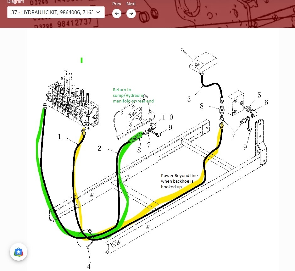

I bought a NH 757C backhoe to put on my TC30. I have the rear mount and have to make the front mounts for the tractor - which isn't a big deal. My issue is I don't know how to plumb the hydraulics. The TC30 does have the loader with what appears to be the factory setup. Does anyone have the manual that shows how to route the hydraulics or does anyone have any clear photos or step by step explanation? Thanks in advance!

Without going through my manuals to find a 757C OM, I attached the parts picture for the hydraulic kit for the 757C to the TC30.
There is a set of quick couplers added to the power beyond from the loader to the backhoe so the loader can be used when the backhoe is detached, but otherwise, the inlet tobthe backhoe comes from the power beyond on the loader.
The return appears to go in the side plate under the seat.

I'm having the same issue I was sold the wrong hydraulic kit by tractor innovations couple years ago its a rear remote kit ..it does not power a backhoe attachment like I was told come to find out I need a power beyond kit so I spent 550$ and still not able to use my backhoe was told I need to connect it directly to the loader valve but not sure where or where to connect the return hose I also have to make the front subframe mounts and can't locate a picture online any one have a tc30 or similar model with backhoe could snap a few pictures of the mounts and hydraulic hose assemblys that power it would be awesome

Hopefully others with a greater understanding of hydraulics and the power beyond circuit of your loader valve can provide advice.
Any chance you can post some pictures of your loader valve and what you have purchased so that others can guide you?

Did you install the power beyond kit you bought?
I see I didn't attach the parts picture
