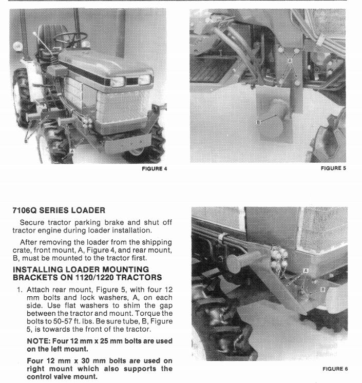

My nephew just got himself a used TC29DA and a week later he got a used 7308 loader to go on it. The loader came with all the brackets though it seems like the bolts are metric? but the tractor is SAE?
Anyone know of any manuals online I can peek at to see if the distribution block needs modified and/or other changes to hook this up correctly?
My dad has a Kubota and I have a Mahindra but this is the first NH.
I have talked to him on the phone but so far haven't seen it yet.

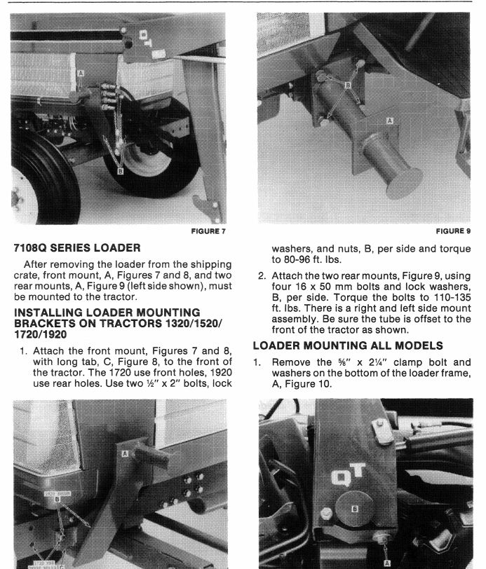

Not sure if this will help, but I have a manual for a 7108
Pics:

If they are similar that will help. Sure is different from the Mahindra and Kubota.
