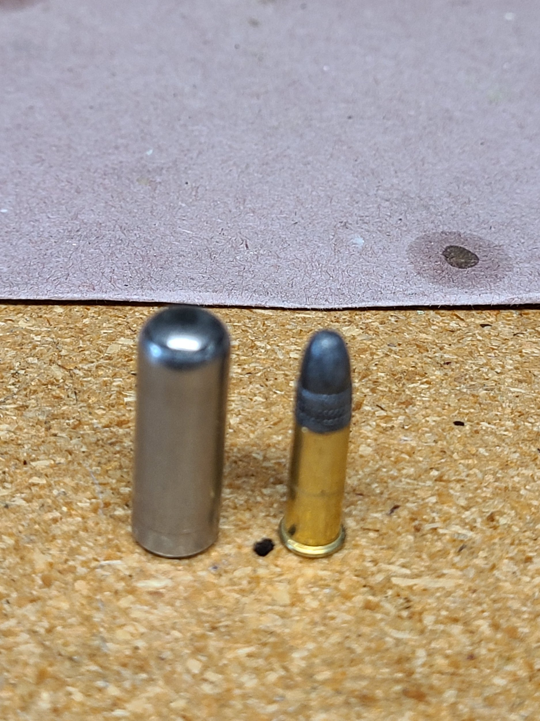

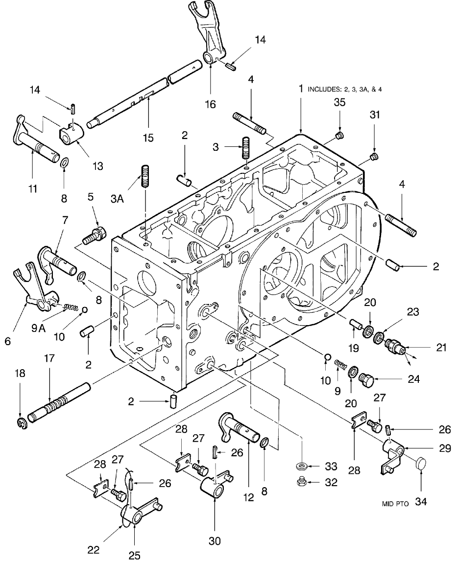

I pulled out the shop manual and went down the line on the testing for "no start" conditions. The manual neglects to mention that removing the rear PTO switch comes with a quick dose of hydraulic fluid. I knew this already as I just did the 9 gallons or so when I did the filters! BUT, I found what I believe is the plunger on the ground after we did jump the tractor and get it moved. Can someone please tell me if that's what it is, and if so, which way is it oriented? One end is flat, the other rounded, highly polished. ** .22 just for comparison...so far!

I wish that was the issue. I checked both with a meter - check my post with the picture with what "may" have fallen out of the transmission from the rear PTO safety switch...

Thanks, that's the way it works on mine, too. I had a little issue when I went to test it...see the photo!

Good idea, thanks! Check the picture to see if you've seen anything like this.
