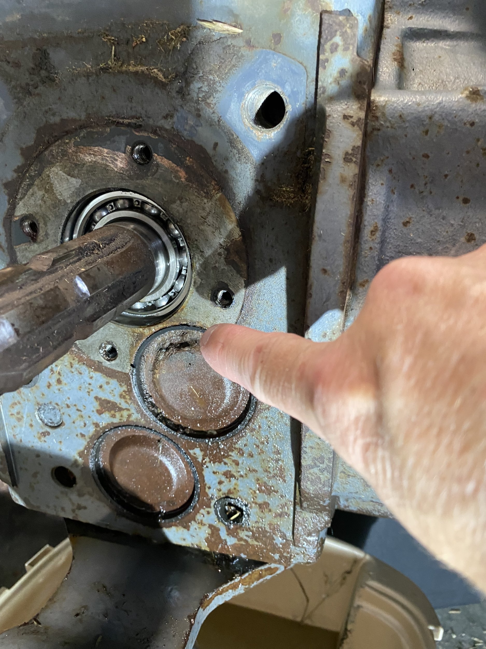

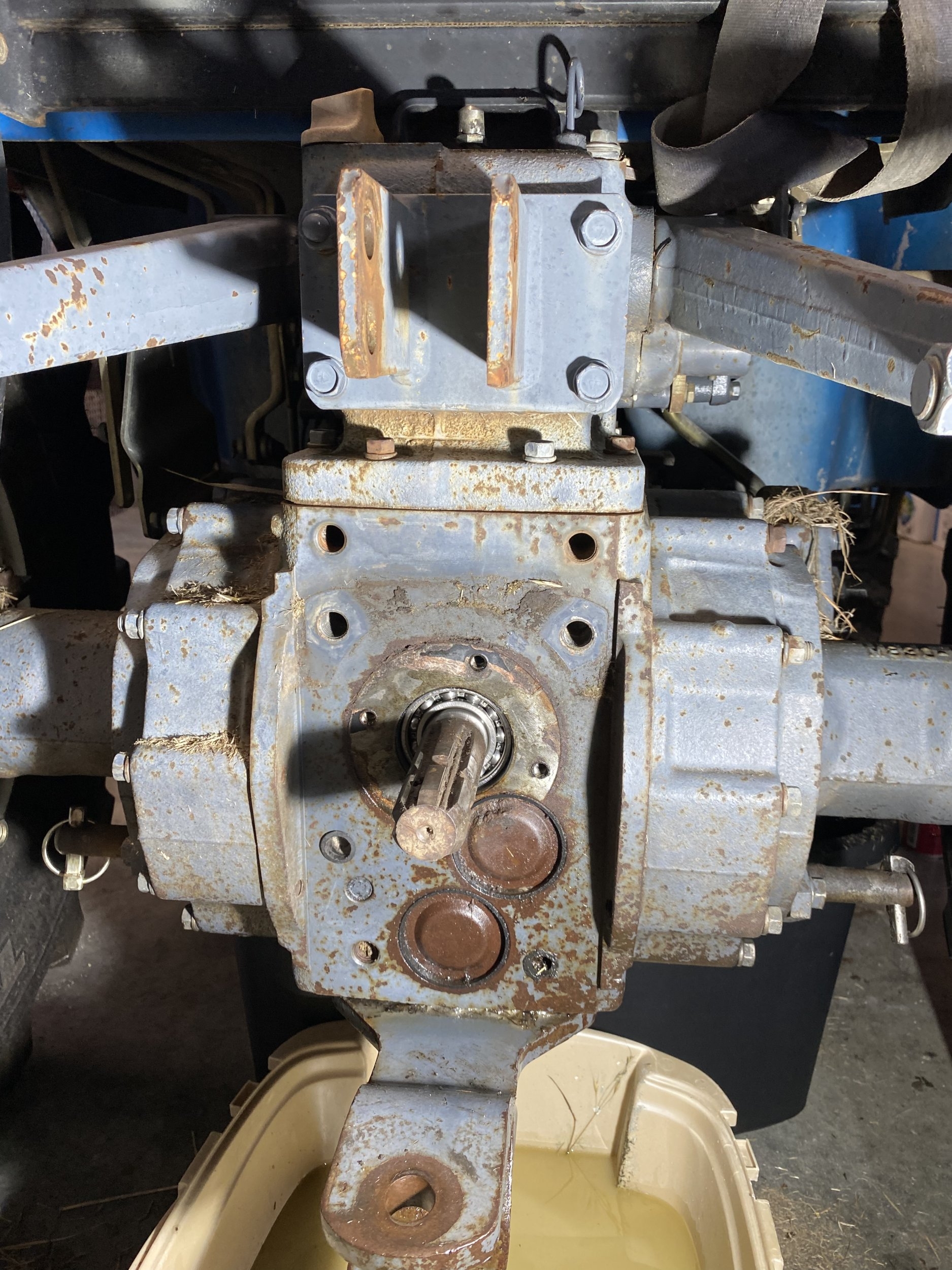

Hi all, been a long time since I’ve been on here but I have a problem. I thought I developed a PTO seal leak. Turns out I was wrong. I now believe it’s leaking from one of the plugs (?) partially covered by the PTO seal cover/casing. It looks like dirt and moisture has collected up under this cover over the years and finally corroded a pin hole thru this plug thingy. The problem is I can’t find these plugs/covers in any parts drawings. That leads me to believe it’s not something that can be replaced. Am I looking at something like cleaning this as best I can and smearing an RTV sealant on or would JB weld do the trick? The two brown circular plugs in the pics. The upper one with my finger pointed at it has the hole in the upper part that gets covered when the PTO seal housing bolts on.

Those plugs are replaceable, just like a frost plug on an engine block.
Looks like Messicks has those. I think this is what you need but definitely confirm that. New Holland #SBA322140280 COVER
   / TC29 PTO leak #3
Part #16 on the diagram.

Wow thanks guys, I looked all over those drawings. I don’t know how I missed those. Guess I’ll be making my third order from messicks this week lol
