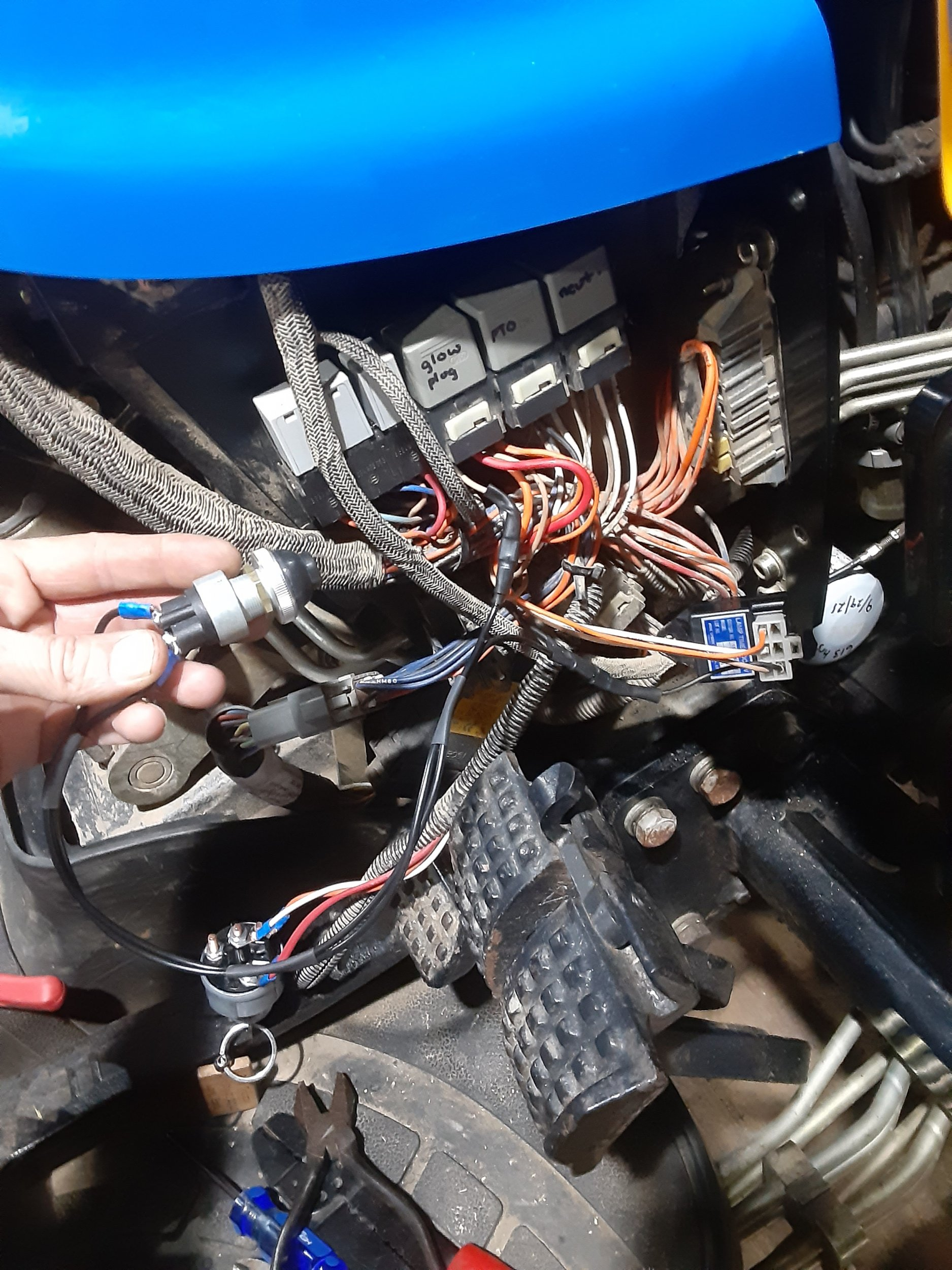

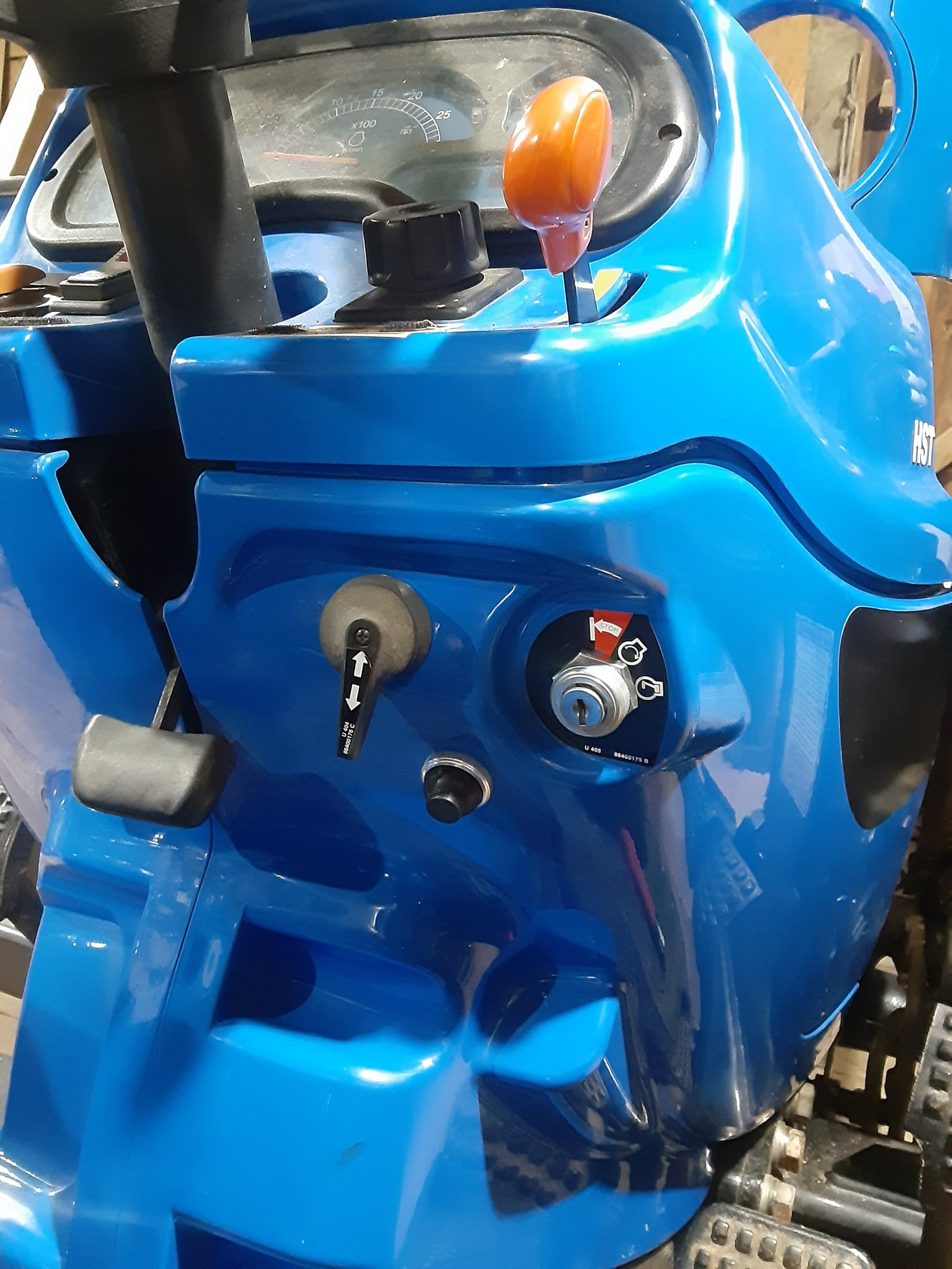

Glow plug button
When the key switch is turned to the ignition (on) position, the glow plugs run for 4-5 second on my model, controlled by a timer. I wanted a push button to add preheat time. I studied the wiring diagram, which I attached (bottom) but the pin number are hard to read on my copy and scanning makes it worse... sorry. Best to have your own if attempting. The glow plug power relay #3 sends current to the glow plugs and a micro-relay that powers the dash light. +12V comes into the relay for this purpose at pin 30 (HM4), and is there when the battery is connected. The switch is closed, sending current out pin 87 to the glow plugs (HM9) and the light micro-relay (HM99), by a voltage drop across pins 86 and 85 (left side of diagram). Turning the switch to "ignition" or "start" puts +12V at pin 86 (upper-right), so the glow plugs are triggered by sending ground to pin 85 (lower left). This is the job of the glow plug timer relay, and it does so under two circumstances: (a) for several seconds when pin 4,C is energized by "ignition", and (b) when pin 5,B is energized by "start."
I added a push button to operate the glow plugs without affecting any other function by splicing into (1) tan wire HM28 running into pin 85 of the glow plug power relay, and (2) into black wire HM12 running into pin 3,D of the glow plug timer relay.
There are many switches out there, but I used NAPA P/N STB6301. It seemed pretty durable, and matches my added NAPA ignition switch, P/N KS6600, as others have done.

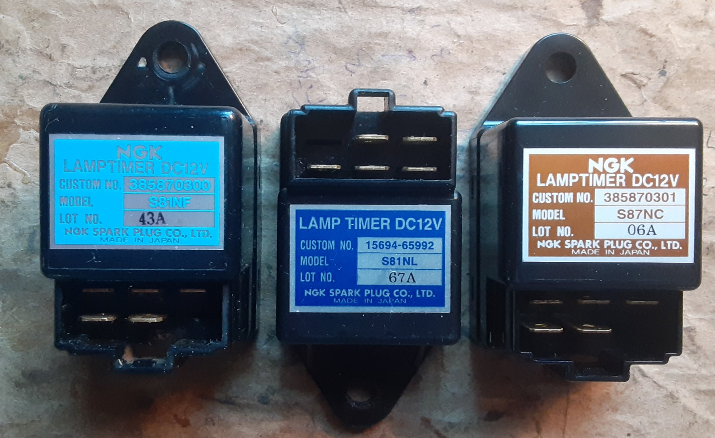

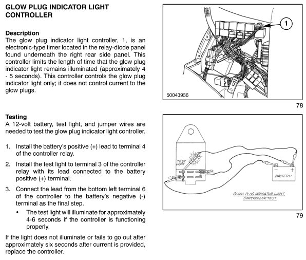

Timer Relay
Aside from this, my glow plugs seemed erratic, and the timer relay (hanging down by the oil filer in the fist picture above) failed the bench test described in the attachment here:
(from the FSM)
So I waned to replace it... The New Holland P/N is 385870300 (superseded by ...301). The NGK model number on my unit it S81NF. A replacement from my dealer is $113, currently. If you search these numbers online, an attractive alternative (which sources claim is a substitution) pops up, NGK model number S81NL. I think it is for a few Kabotas, and it only cost me $18 on eBay! But, here is the catch... the timer function works fine: function (a) above, but it does not trigger the glow plugs when starting: function (b) above. I'm not the first to notice this. See post #5 from SG51Buss here:
At this point I have my original unit which has an erratic timer but works in the "start" position and a pseudo-replacement that has a good timer but does not energize the plugs in "start". I confirmed all this with bench testing and checking voltage at the glow plug busbar on the tractor. My original timer still starts the tractor. The replacement won't. At this point I coughed up the $113 for the replacement from the dealer, and it performs (a) and (b) as it should and (most importantly) starts the tractor. In the picture below they are: original (left), cheap alternative that didn't work for me (center), and dealer replacement (right).
P.S. I feel the urge to clarify some poor wording in my FSM that seems to have confused/mislead some about the timer relay. Here is a snippet from my page 55-39:
Look at "This controller controls the glow plug indicator light only; it does not control current to the glow plugs." Think about that... So then what *does* control the glow plugs getting energy for a few seconds if not the timer?! Besides, if you review the wiring diagram, as I did, you see that the timer triggers the glow plug power relay, which energizes the plugs. So the timer does not send current to the plugs *directly* but it sure does determine when the power relay energizes them. Also, the label on pins 3 and 6 in figure 79 are switched. I won't post another picture, but I pulled the circuit board out of my original unit and the pins are labeled. They didn't have the best person proofing this section of the FSM!

Here is a brief clarification and update on performance.
I mentioned that pins 3 and 6 are switched in figure 79 of the FSM (compared to the circuit board) in that last image I posted. This is true, and the text to the left "follows" that switch. Meaning that a user could follow those directions exactly and the relay would be tested properly. Problems would arise, however, if one compares these pinouts and their wires to the wiring diagram. Then you must realize that pin 3 is physically in the lower left. The bench test described in the first link in my original post is this same procedure from a different FSM that gets the terminal numbers correct (with letters). Sometimes the terminals are labeled with letters, sometimes numbers. A=6, B=5, C=4, D=3, E=2.
I used the tractor to clear snow from our recent storm. Temperatures were below freezing, but not far below. On turning the key to ignition, the timer ran the glow plugs for 4 seconds, as it should. I used my button to add 12 seconds to that before attempting to start the tractor. It fired up as if on a bright summer day! I did not use the block heater this time, intentionally, to see how this would perform. It's only one time so far, but I believe there was clear improvement.
