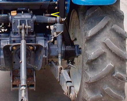

Hi Guys,
I am new to the forum and just bought a TC29 and am trying to get the 3-point working. The tractor has a bushhog 1846qt loader which works good and appears to be hooked up correctly. It has power beyond and the diverter valve is set in the 10'oclock position.
The problem is I can not push the 3-point lever down to lower the hitch. I tried to check to see if the valve under the seat was closed but something does not seem right there. There is a hole under the seat where it looks like the knob would be but it is recessed inside the tractor body and i can't reach it. Maybe something is missing and this is the cause of the problem? I have attached a closeup picture. If anyone could give me some hints on where to go from here that would be great. Thanks.

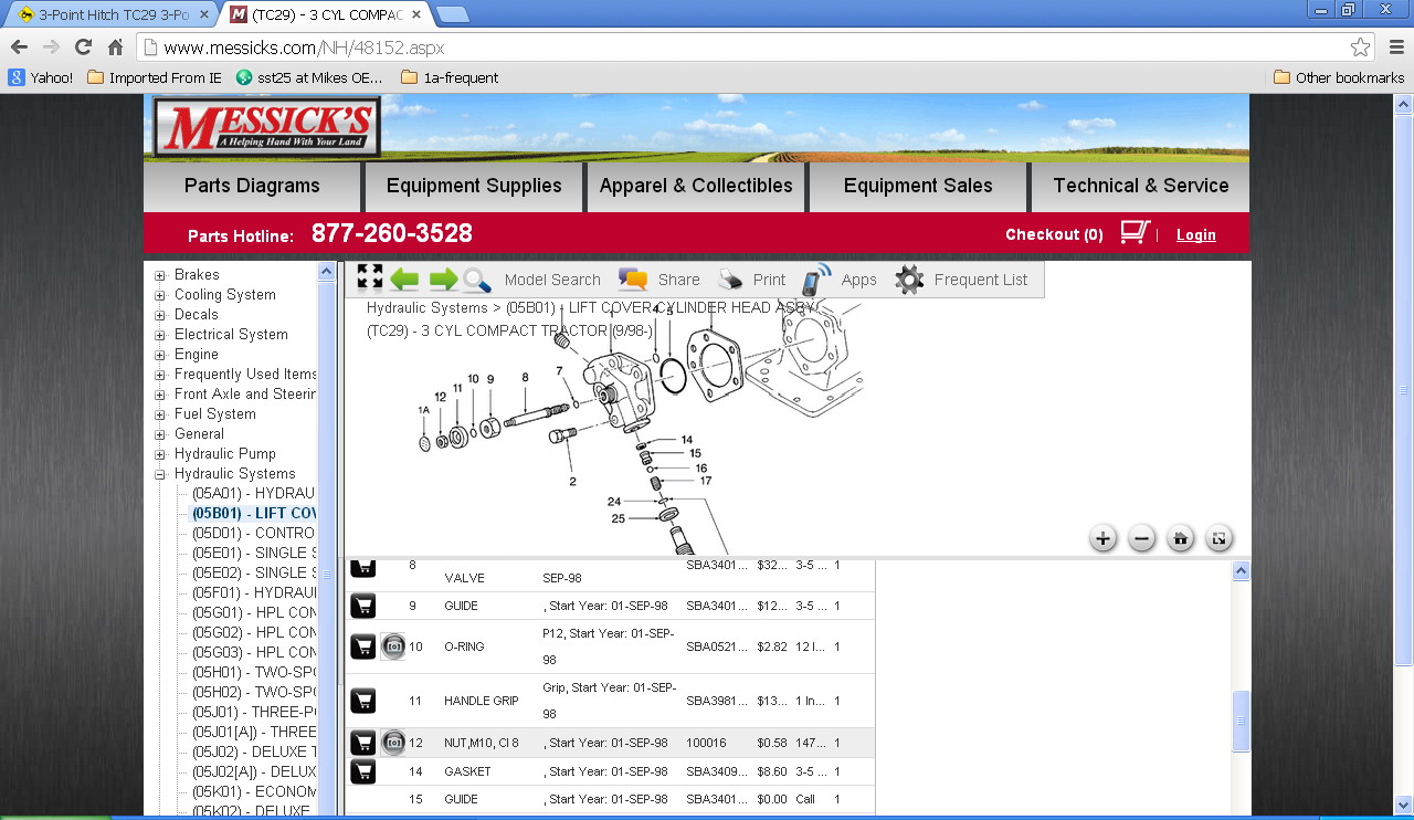

   / TC29 3-Point Won't Lower #5
Darrell, your photo is of the drop-rate knob. The little cover in the middle is supposed to have arrows on it for adjustment. CCW=open (faster), CW=closed (slower). Here is an illustration that shows the adjustment and it's components. The black plastic (item 11) is the knob.
As far as your lever, sometimes they are very tight because a castle nut needs to be adjusted. The castle nut has a cotter key through it to hold it in place. See items 12 and 13 in the diagram below. Also the photo that follows has a yellow arrow pointing toward the location of that nut and cotter key. Remove the cotter key and loosen the nut until your lever moves, then re-insert the cotter key to hold the nut in place.

Should the 3-point lever move even if the drop rate valve is closed all the way?
Should part 8 in the parts drawing jinman posted extend through the body of the tractor and have the knob on the end of it? On my tractor all I see is the black knob right against the descent unit housing.
   / TC29 3-Point Won't Lower #8
Yes, the height lever should move independently of the drop rate setting. It seems to me that maybe your drop rate knob (part #8) has been removed and there is only the guide there (#9 in the drawing). Is your tractor the HST model or gear model? Is it possible that somebody removed the original seat and blue sheetmetal panel below and replaced it with one that does not allow access to the knob? Can you pop the silver cap off to see the nut below? If you can, maybe you could use a socket on the nut to adjust the drop rate. Surely somebody else with a TC29 can answer your question. I can't say for sure because mine is not that model.
