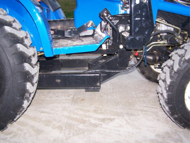

Here's some pics of the mounting set-up.
This one shows the front part of subframe mounted to the frame under the loader brackets.

   / TC26 and Woods 6000 BH #6
Here's one of the rear. I don't have to remove anything other than the top-link of the 3pt. The lower-lift arms tuck inside the sub-frame of the BH.

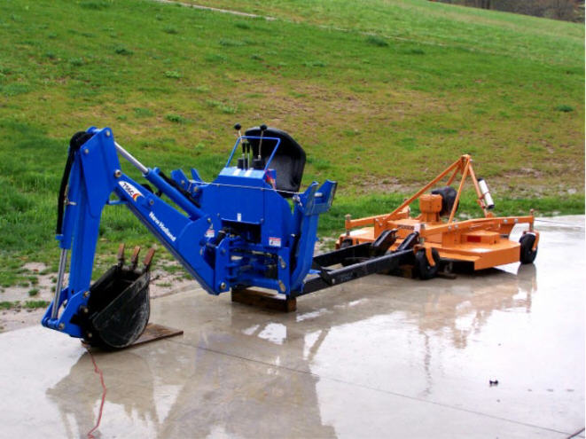

   / TC26 and Woods 6000 BH #7
Last one. This shows how the whole subframe comes off with the BH. I have no problems with changing filters, etc.
Good luck with your BH, hopefully it's worth changing filter locations, etc.
