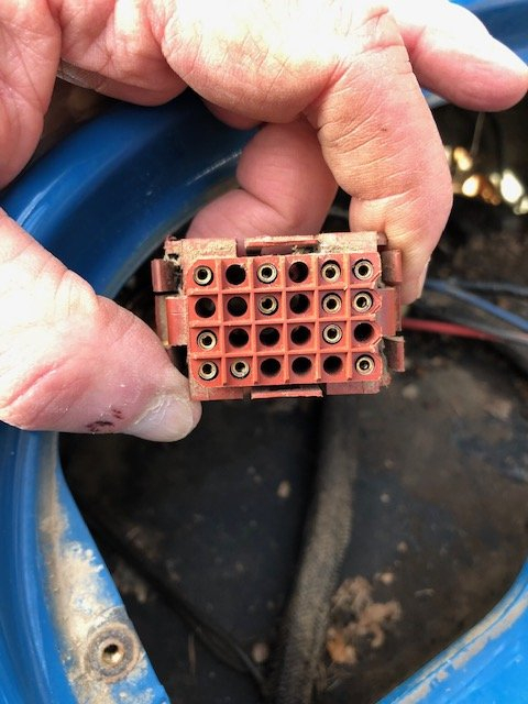

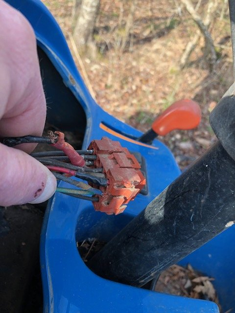

Mice, squirrels and snakes seem to enjoy living behind the instrument console of my tractor. I have several wires chewed right up to the the point the wire enters the connector. I would like to replace several wires within the connector. Can anyone point me to info regarding replacing pins/wires in the instrument cluster connector? TIA.

you need:
a pin extraction tool set to get the old pin out out of the connector.
a new pin and a crimper with the right die.
you dont need to replace the connector, unless it is damaged.
   / TC25 Dash Multi-Pin Connector #3
Those might be Molex connectors. Kits are available that have the sockets and the removal tool. The removal tool is tubular and is inserted from the front (non wire) end and compresses two wings that allow the terminal to be pulled from yield back of the plastic housing. If you manage to get one out, a picture could further help identify the style.
