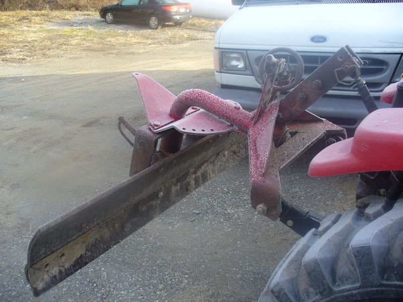

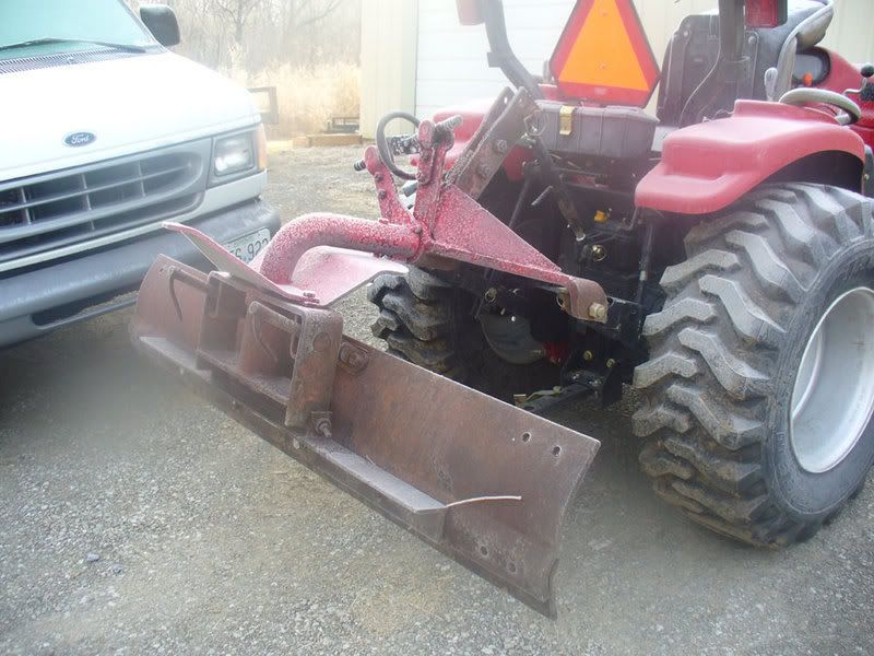

Pat,
Attached are some pics of a older 6 foot blade on my tractor. I used this blade with my DX24 (currently have a DX33). I'm not familiar with the blade you mentioned but the blade in my pics is a beast. It has 1 foot extensions I can add to each side to make it an 8' blade. One single extension weighs about 70 lbs. It's extremely heavy and I had no problems using it on by DX24. The machine had plenty of power and would pull sideways when accumulating too much dirt before it ran out of power. One benefit of a heavier blade is that is will dig a little better when grading where a lighter blade just kinda skims across the surface. Hopefully someone else is more familiar with the King Kutter blade.

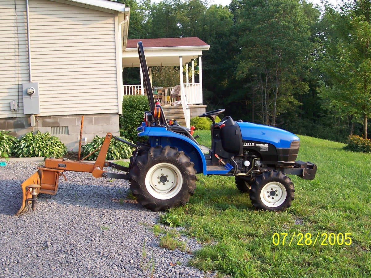

hears my RB3572 behind my 33
works great, ive stalled it out a couple of times but only while trying to "dig" out the better part of 6" of dirt with it... (figured i needed to take less of a bite)
it easly shaves 2" off the hard packed gravel drive when slanted as shown.
i cut nearly 4" off the edge (high area) to restore a proper crown to my driveway (or at least let the water runn off instead of puddling in the rut)
defently a low range operation....
