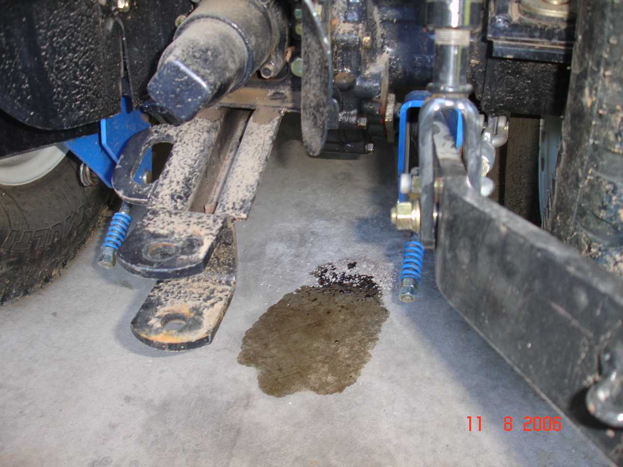

I have had a small oil leak for about eight months on my TC24DA. Occasionally, I would find a fresh drop of oil under the rear axle which appeared to have fallen from the "pumpkin". When I took the tractor to my dealer for the 50-hour service, I told them about the leak and they said they would fix it. My dealer explained the pumpkin fit together with a machine fit and there was no gasket. They claimed the problem was fixed but the drip returned within one week after I took it home.
Recently, I walked to the garage and found a large puddle of oil under the pumpkin. I took a picture and attached it to this thread. I checked the bolts around the pumpkin and they were tight.
Has anyone else experienced this problem? I welcome any comments or helpful advice.

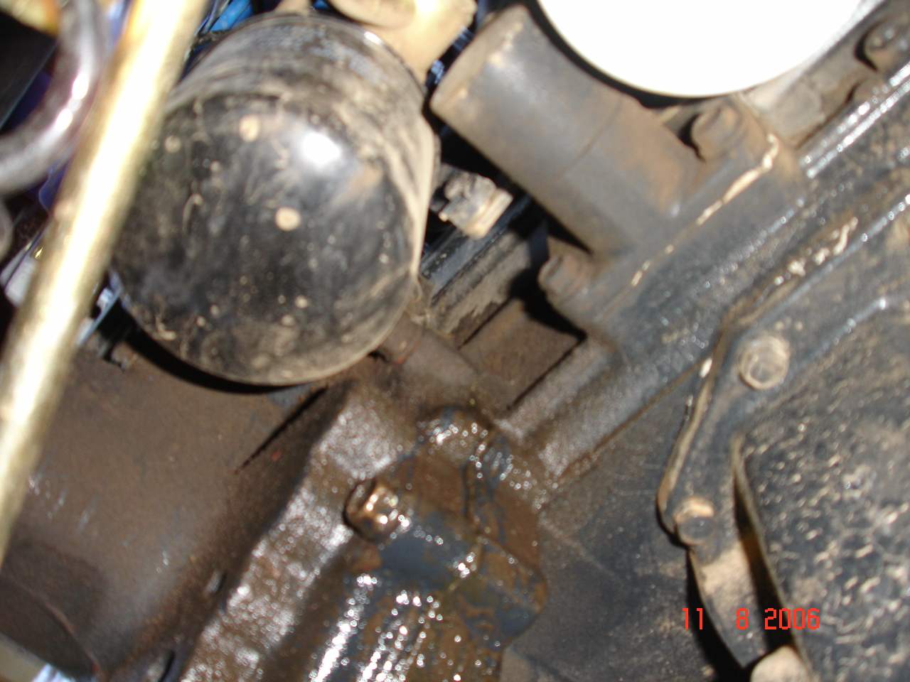

Here's a close-up

I think that gentle power wash would help. Oil can appear to becoming from one spot when it really is coming from another. Then, put some waste card board underneath it and then take time with clean paper towels to look for the site of origin. Guessing where the leak is coming from is a waste of time and expensive. You can do all the work of finding the site of the leak, then direct the dealer or TBN to the site for the right fix. This is not the time for guessing. Too costly.

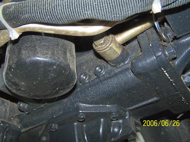

Jeff,
I've been off of here for a while. I had a "mystery" oil leak to and found that this fitting forward of the hyd. oil filter on the right side was leaking. Can't remember what size metric wrench fit on it but I was able to snug it back up and no more leaks. It amazes me how an oil leak travels from one place to another before it shows up! Hope this helps. Joe
