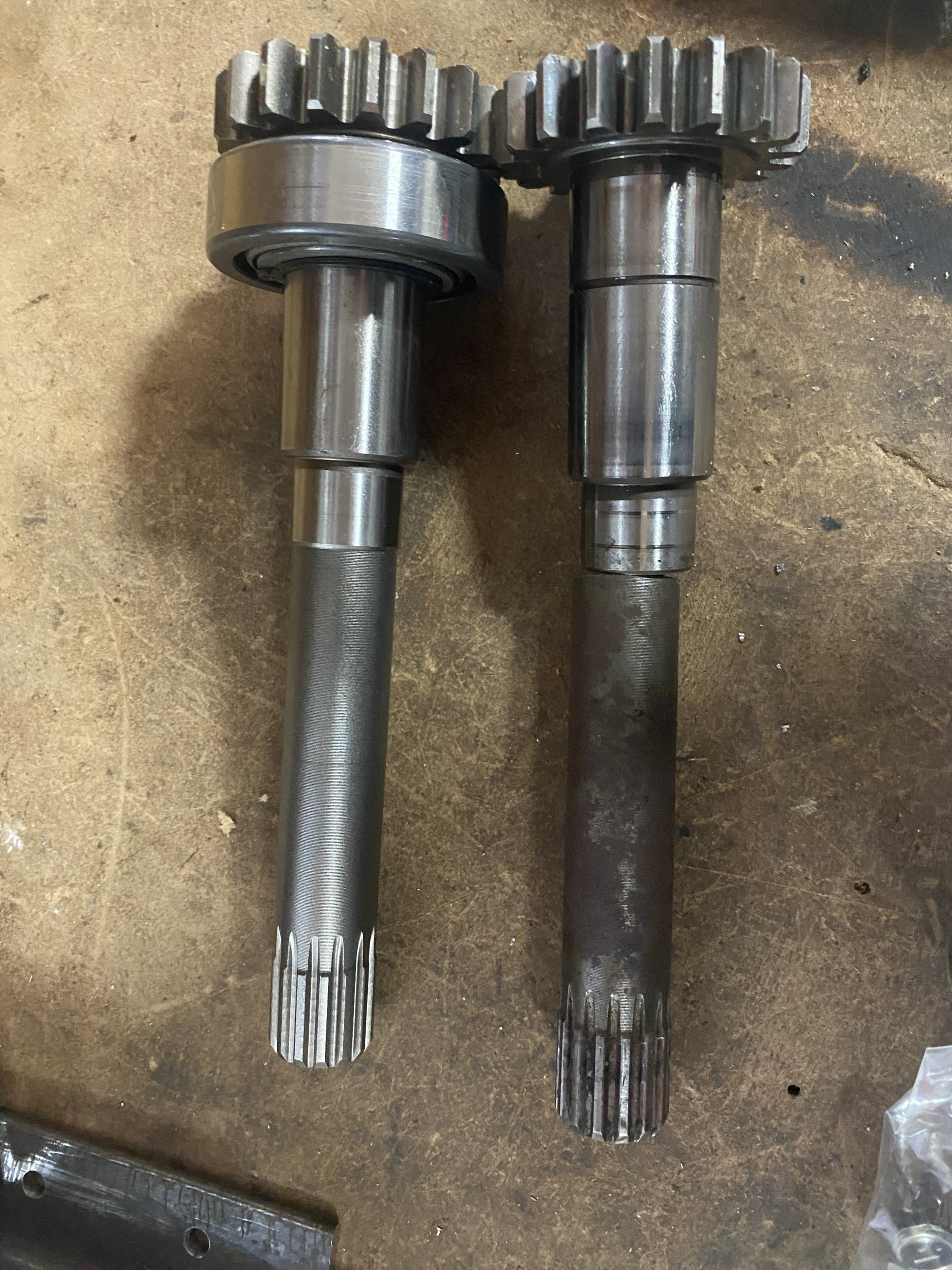

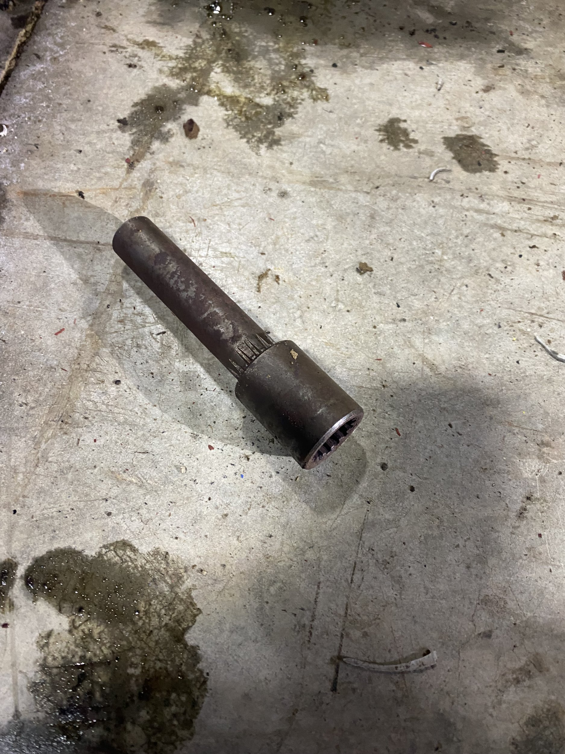

Anyone have a picture or line drawing of New Holland part number SBA322513530? Unfortunately, looks as if I've sheared that shaft and would like to verify the aforementioned part number is correct, before ordering. Yes, the tractor split in two, which I'm guessing is what broke the shaft.
Thanks in advance for any help!
Derek

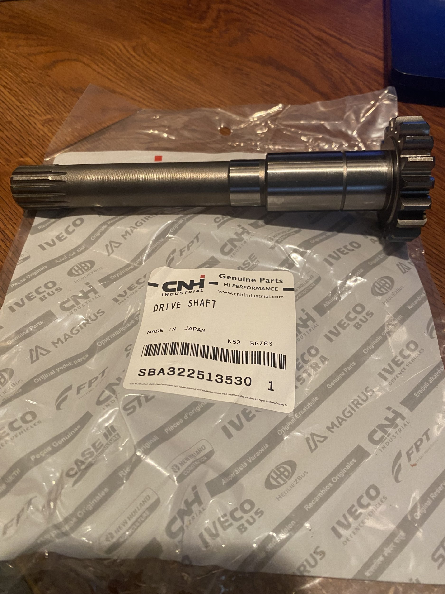

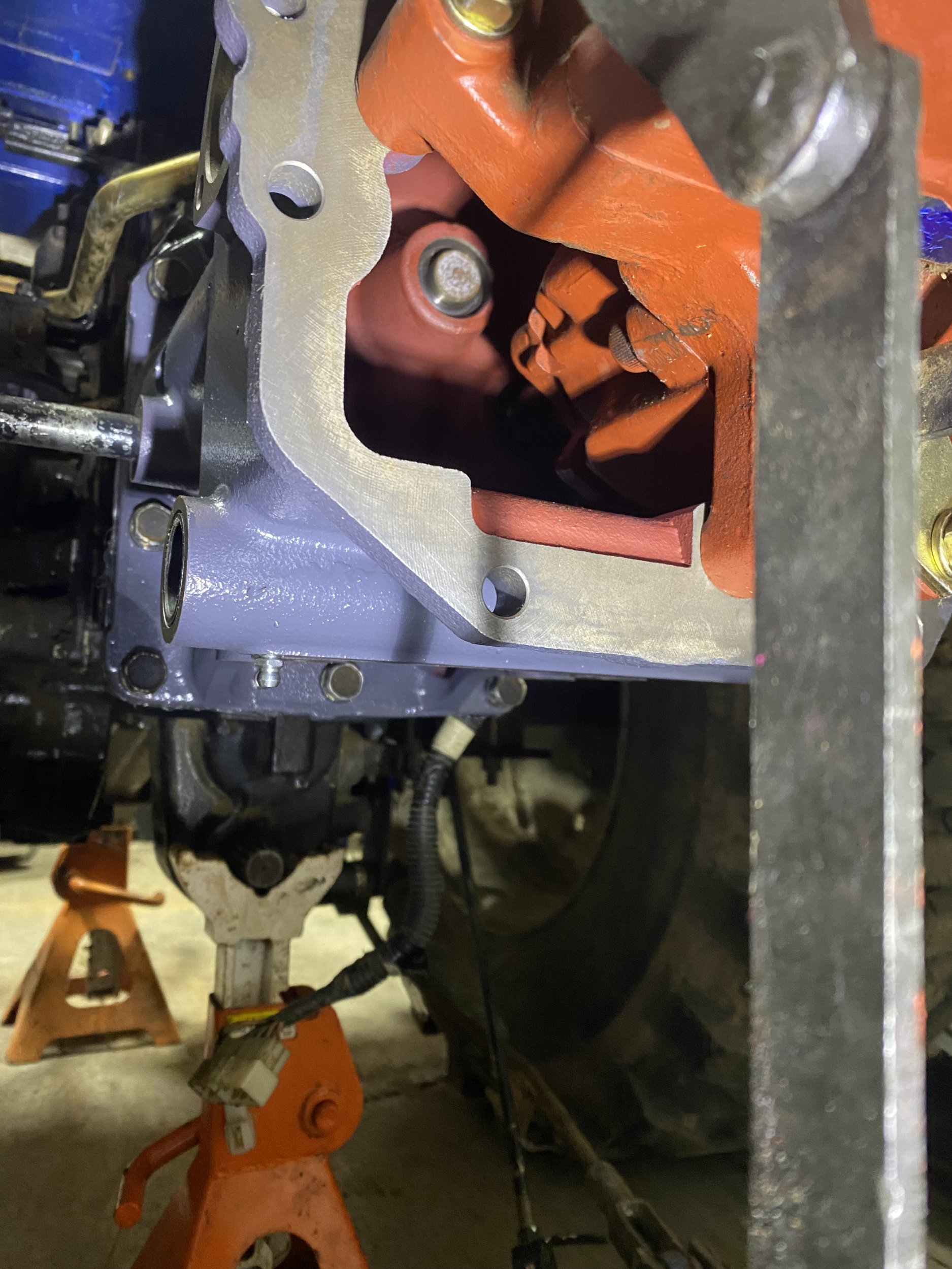

Adding this for future reference in the event it can help someone else.
