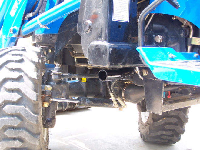

I posted this in the NH forum but thought others would like to see it. I had a local muffler shop do the work. I was tired of all the fumes coming back at me after bouncing off the loader bucket, not to mention all the soot all over everything in the front. Now it exits out the left side under the loader subframe. It does not stick out past the subframe as to avoid burning leg or being torn torn off while in woods, etc. It works really great, no more diesel fumes, smoke in my face and I was able to leave the stock muffler and part of the original "tailpipe" alone.

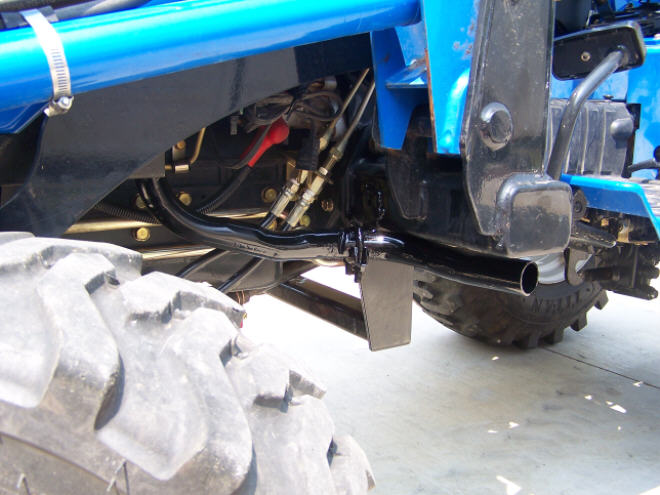

Another view.

That looks really good. Pretty slick.
   / TC24DA Exhaust Mod. #4
I'm in to much tall dry grass to feel comfortable with that. Looks good ...
Leo
   / TC24DA Exhaust Mod. #5
</font><font color="blue" class="small">( I'm in to much tall dry grass to feel comfortable with that. Looks good ... )</font>
Leo,
At night, do you see sparks from the exhaust?
   / TC24DA Exhaust Mod. #6
Yes there are a few, not much. Seems like like the 8N's we had years ago had an exhaust below the hood something like this one and they were never a problem. I maybe a little hyper at the thought of Fire in an dry field.
Leo
