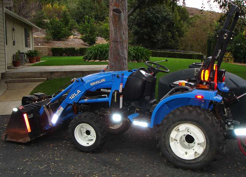

Anybody have a picture of a TC24 equipped with wheel weights? Is there a genuine New Holland item or are they all aftermarket? The ones that I picked up do not fit inside the rim and are not made very well. Thanks.

Hello, I have the New Holland rear weights that I purchased new when we graded our new driveway. We needed a bit more weight to push around the Class II base that formed the foundation for the concrete approach and driveway. Also working on steep terraces required a bit more weight closer to the ground.
The weights are of poor quality and somewhat ill fitting. I had to get the right sized carriage bolts but I am using the wrong grade. They really should be Grade 5 but Home Depot only had the $#% ones. They require frequent retorquing and I dread removing the weights so I just let them be. I have found them to be a worthwhile investment in steel or is it iron?
Here are a few pictures (as requested)

George, thanks for the photos. They look better than the ones that I got, but seem to have the same issues I was concerned about. Difficult to mount/unmount, frequent retorquing, etc. I'm thinking of making fabricating a bracket with a single threaded rod that I can mount to four bolt holes in the rim. Then mount 2- 50lb barbell type weight on the rod. It would be easier to mount/unmount and should not work loose. It would also fit deeper in the rim instead of on the surface. There are some others that have done this on the forum and it looks like a good solution to me. Thanks again for the picture.

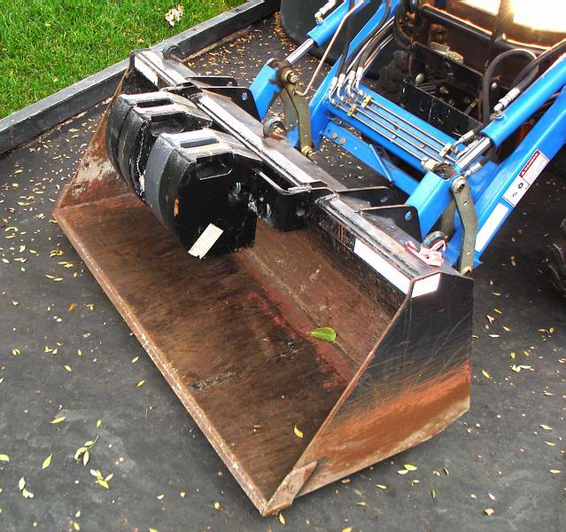

Sorry can't help with the weight issue but I saw the picture of your tc24, what is attached to the fel?
Badge142
   / TC24 Wheel Weights #10
Badge 142, what you see attached to the FEL is the New Holland Suitcase weights that were added to counterbalance the rear fire rig attachment I added to the tractor. The bracket started out as a 3-point suitcase weight attachment but never really used it that way. I then had the need for more weight on the front end and so……….yet another custom weld job.
My observation is that additional weight seems to make back blading in the float position more effective. Also they are easy to remove when needed. /forums/images/graemlins/wink.gif
I have attached a close-up of the FEL with the weights.
