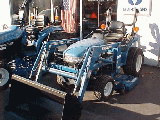

Thanks for Everyone, who is trying to help me with my decision. I got some info on the used TC21d with the loader, and 60" MMM. It was used by a farmer to run a grain elevator on the rear PTO. Its got 600 hrs on it and is a 2000 model. I've attached a picture if anyone wants to see it. Is that kind of use harder on a tractor, and is it still a good buy???? Also a question on the R-4 tires, does anyone have them, and do they dig up the yard when mowing???? Thanks again Guys!!!!

   / TC21d VS TC25d #9
I have the R4s. If you turn sharp enough and the ground is soft (after a rain) they will leave marks, which disappear after a few days. If you're going fast enough they'd probably dig up the yard.
The dealer building in the background looks familiar. Who is it?
   / TC21d VS TC25d
MIkePa Its Charles Snyder in Tamaqua,Pa. I figured you may be familar with them!!!
