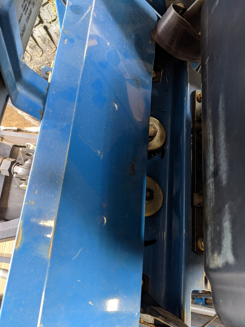

   / TC18 Where's the Hydraulics Dipstick
Behind the seat is a toolbox and I don't see any dipstick/plug.... I attached two pics, one is drain plug and the other is behind seat.

   / TC18 Where's the Hydraulics Dipstick #4
According to the picture, it should be IN FRONT of the seat, as Eric stated.... NOT behind it where the fill hole is
Holly molly I read Eric's post and still went for the back....🤪 LOL I'm so sorry! I found it, that baby blends in like a bolt and is gray to boot!
