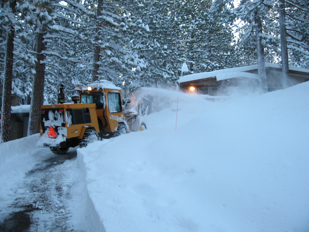

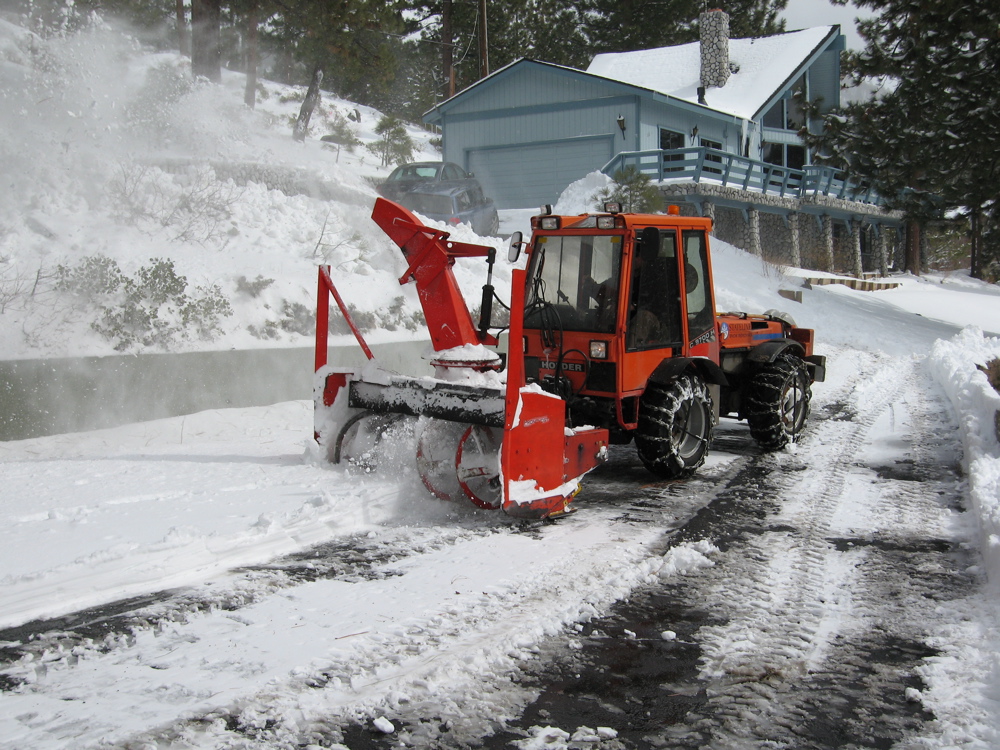

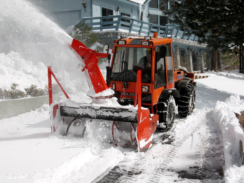

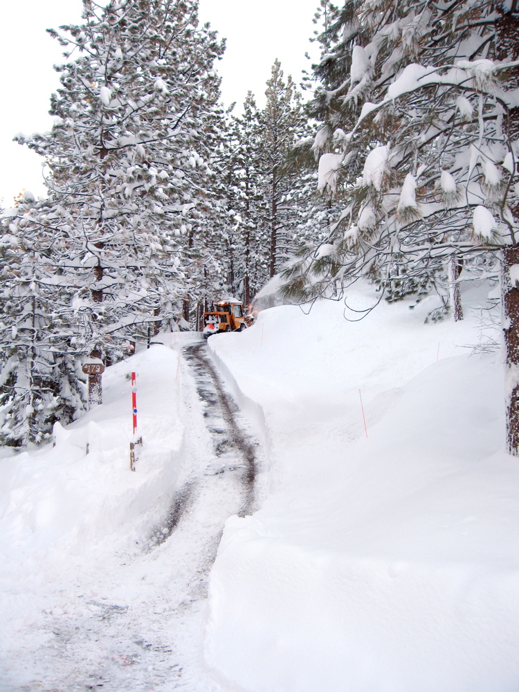

My TC with SB200 is not effecient to do any of this, but it will with enough time. The driveway with the Holder tractor would be its best shot, but the berm was 4'. I spent 12 minutes clearing the berm and driveway (3 car garage with room to park at least 4-5 cars abroad outside and 80' long.) to my insane perfections. One of my drivers would have been out of there in 7 min.... No berm to punch through - make it 4-5 min.
The TC is being picked up today for final fittment to add a blower exactly like the yellow machine, but hydro powered. The yellow machine has 101HP and tones of torque. The Holder has 75HP and is still very efficient. Will TC have enough power? Probably not, but it just needs to be improved in both size and effciency abit more for me to keep it.
Tough move is that when smaller amounts of snow fall the TC is close to even ground in speed of clearing driveways. That makes the cost savings very worth while. When the big storms arrive I will have to park TC and finish with holder. TC sitting idle doesn't pay the bills!

What is the yellow machine? It will be interesting to hear if a different blower makes the TC worthy. The D-Series has a new horsepower management system that uses a throttle sensor to determine the best engine RPM to manage power output, and also true cruise control that monitors ground speed instead of system pressure at the drive motors.
I see you have chains on the Holder. Do you ever have any problems with blacktop marking?

Chains stay on the Holder all-year. They're just too heavy and cumbersome once on. Same goes for the wheel weights. (yes I have to a jack or ramp when placing the wheels on.) Using two link spacing really helps reduce chain marks. Hardfacing the chains will extend the life, but is time consuming. They will leave chain marks on newly sealed surfaces, but it's only superficial.
The TC is running LT tires that are sipped (sp?) and studded without problem. For counter weight on all machines I purchased large steel beam and welded one end shut. Next Les Schwab Tires GAVE me 500# in used lead. Fire up the propane torch and melt as much as possible. Button up the other end and tack on a lifting point. About 600-700# in bed of TC and LT tires gets me up steep drives.
The yellow machine is a Trackless MT V.
