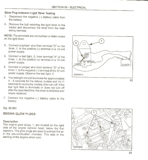

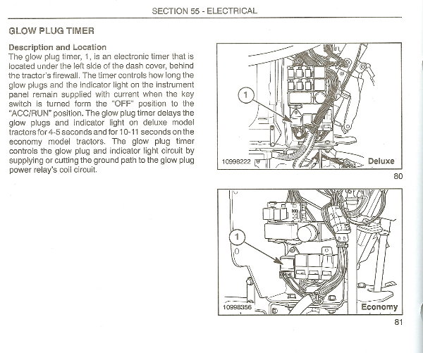

Tc 40D with 462 hours. Last month or so the glow plug light might come on or might not, but always started. sometimes the light would come on and stay on after running for a good while. Like 5 minutes or so. This morning after a 5 degree night, it wouldn't start. The glow plug light comes on and shuts off after 4 seconds and even "clicks" when going out. Are my glow plugs junk or what? How do I check? Is there any other way to get it to start? I cracked the bleeder and it is getting fuel.
   / tc 40d wont start #2
"Won't start" as in cranks and won't start, or no starter turning?
Cranks and won't start is a fuel delivery problem (your fuel filter and line have gelled due to low temps.)
No starter turning is no electricty (battery, connections, safety switches, fuse #2.)
Also, sounds like your glow plug timer needs replacing.

   / tc 40d wont start
Sorry for the vagueness. Tractor cranks fine and fast enough to start, just doesnt fire. I cracked the bleeder line and had what I thought was plenty fuel coming out as it cranked over. Maybe it is gelled. Would the glow plug not working keep it from starting?

You could have a couple of problems you're dealing with; Glowplugs and fuel.
You should start with a voltmeter on the glowplug connection on the top of the engine at the front. This will tell you if you even have voltage and for how long. On my 40D, I turn the switch to the glow position and then back off, and then on a second or even a third time when it's bitterly cold.
Also, I know the theory is that glowplugs are only used when it is cold, but my experience has been on my 40D that if I don't use them, even when relatively warm outside (engine still cold - not just ran) it take more cranking and more black smoke results than when I give it a few seconds on the glowplugs.
Secondly, you need to see if you get fuel at the pump. There plenty of posts existing dealing with bleading the fuel system. Typically you are going to loosen the bleader on the top of the pump.
Lastly, regardless of the outcome, you may want to add a block-heater if your tractor often is exposed to such extremes. Not that you'd leave it on all the time, but if you know you are going to use the tractor, plug it in several hours or even the day before.
   / tc 40d wont start #9
I'm almost positive that your glow plug timer has gone bad. A new one can be had for $40-$50 dollars. I had almost exactly the same experience when mine went bad and I have the same tractor with about the same hours. It is fairly easy to install. If the timer fails again I am going to abandon it. The timer unecessarily complicates what should be a simple system, I can install a push button and count to 20 myself. Do a search, on this forum, for glow plug and glow plug timer and you should find more info.
