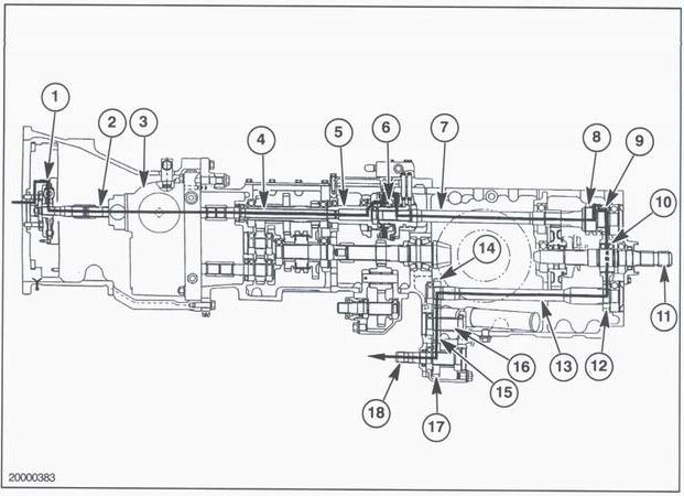

Because of the PITA location of the hydro. fill port, I have over the years tried to devise different ways to fill it. So today I got a small funel and attached a short piece of plastic tubing to the funnel, and stuck it in the fill port. While adjusting the funnel, the plastic tubing fell off into the "unknown". Stuck my fingers in there to no avail, it's down there deep. So I tried to take off the plate holding the top link, figuring I'd have access into the "unknown". Can't budge even one of those nuts/bolts. So now I'm stuck.
I'm unsure of what's in the "unknown" down there but I'm willing to bet I can't leave that tube down there. Any suggestions on how to get the bugger out?

I about the only thing I can think of is trying to grasp the tubing with one of those log skinny retreivers that has the claw like end.They look like a piece of choke cable.

I wonder if a parts diagram of the area would help you get a picture of the unknown? You might look here New Holland TC40D Parts In any case, I hope you will share your solution. Good luck!

Sorry about your mishap, Fred. The best photo I can find that shows the rear of the transmission is the PTO driveline cross-section. The hydraulics sit right above the rear PTO countershaft and final drive. I suspect your funnel tip dropped all the way down out of the hydraulic jackshaft area and is in the PTO section of the final drive. Frankly, without one of those fiber cameras, I doubt you will ever find the tubing. I also think that since the tubing is not metal, you probably dodged a bullet. When it gets down to the fluid level, it may just float rather than sink to the bottom. I believe there is a support wall in the rear of the case that will keep the tube from leaving the PTO area and moving forward in the transmission case. Also, I know you don't want to think about this, but I'd bet the plastic tube would just get chewed up rather than cause any problem if it got into a gear. Here's the illustration of the area below the filler port.

IHFARM -- Thanks, but the first thing I did was look at the IPL. Unfortunately, it doesn't tell me if I can access the rear of that housing from the mid pto position. Since I don't have a mid pto I figured I could drop the cover plate and fish the tube out from there.
