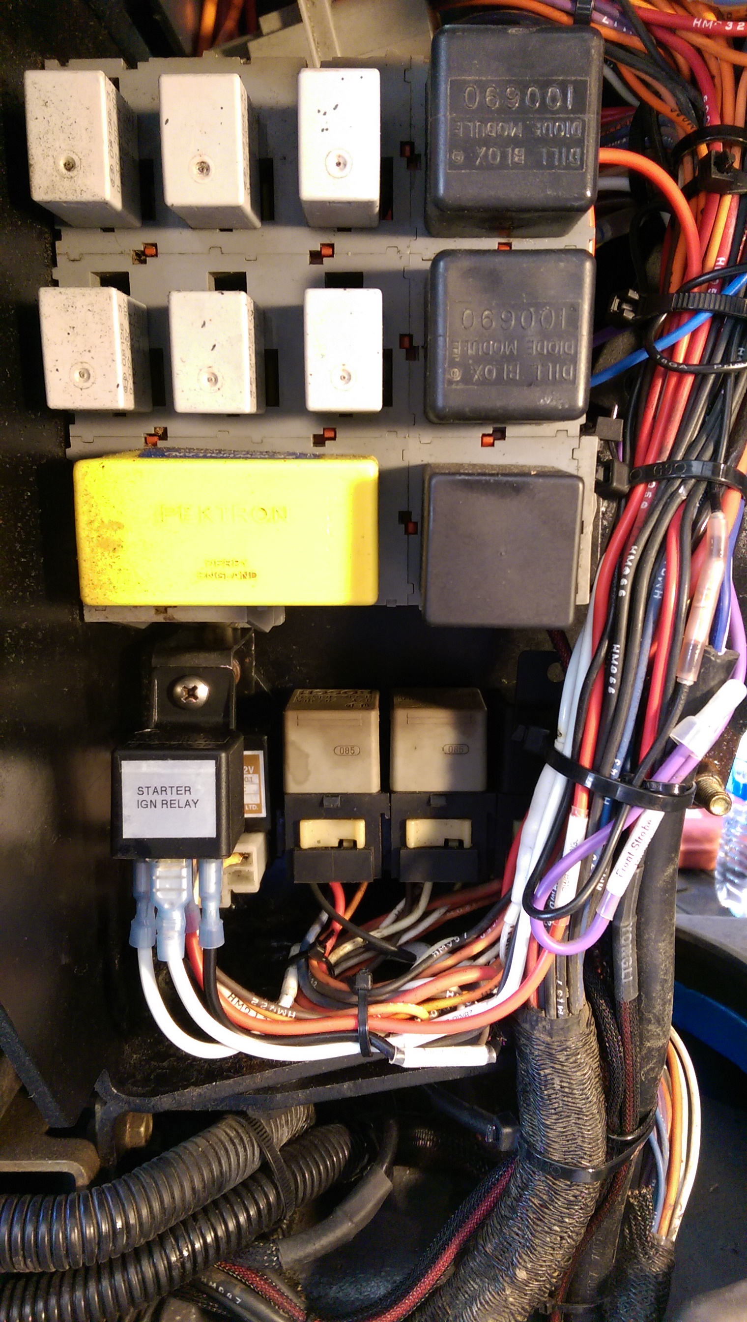

Well that didn't take long... Acted up again yesterday (luckily I had ordered the glow plug timer prior based on how it was reacting); pulled it a part today, tested & then replaced the timer. All is well so far.
While I was in there today I also (finally) installed the ignition relay upgrade I've been wanting to do...

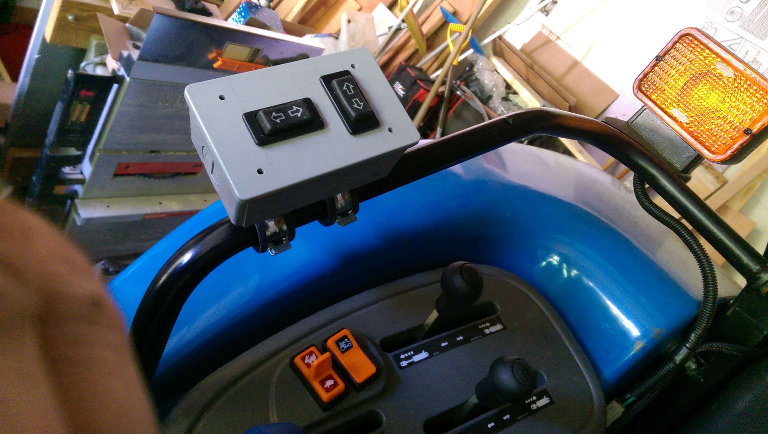

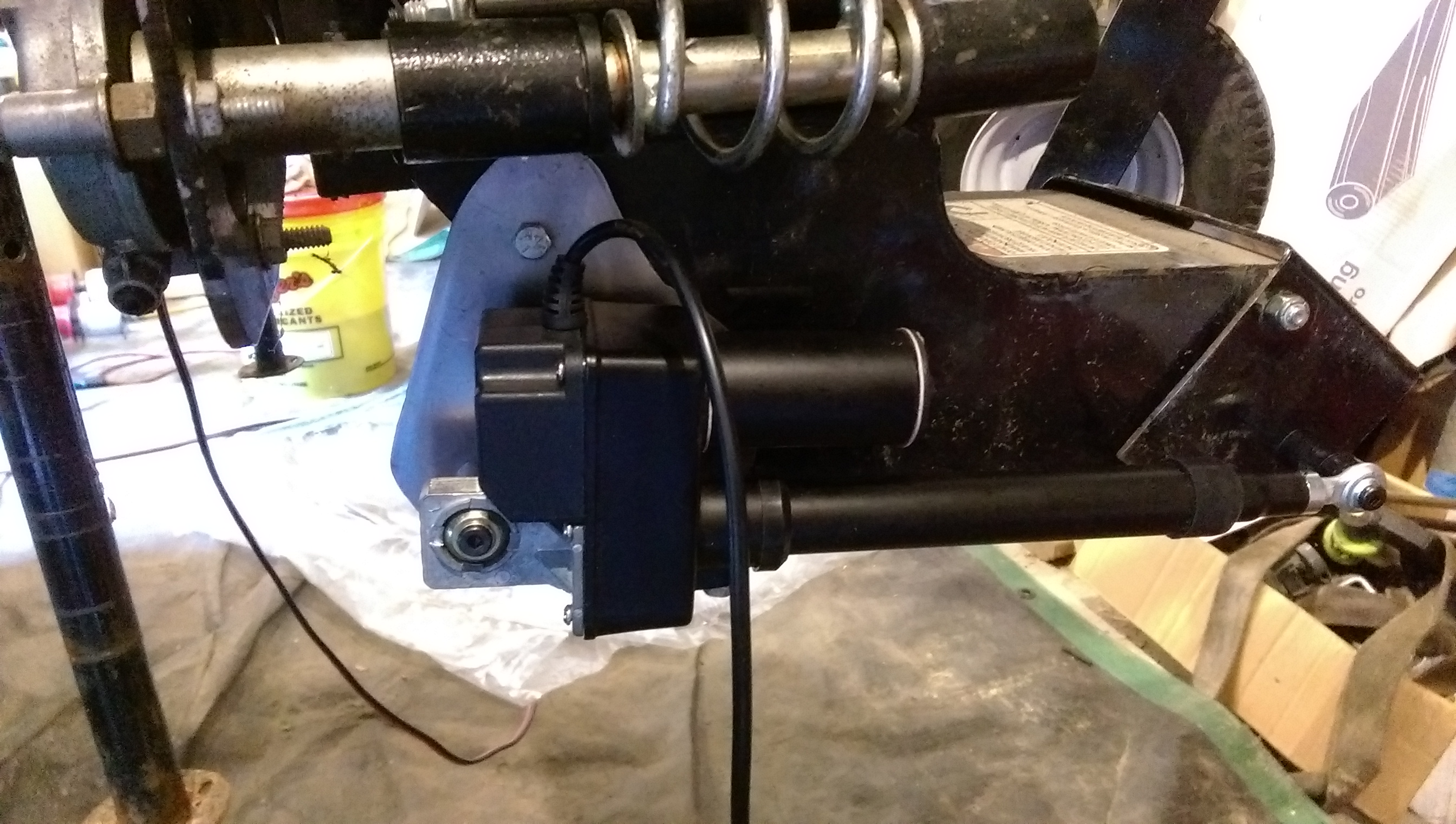

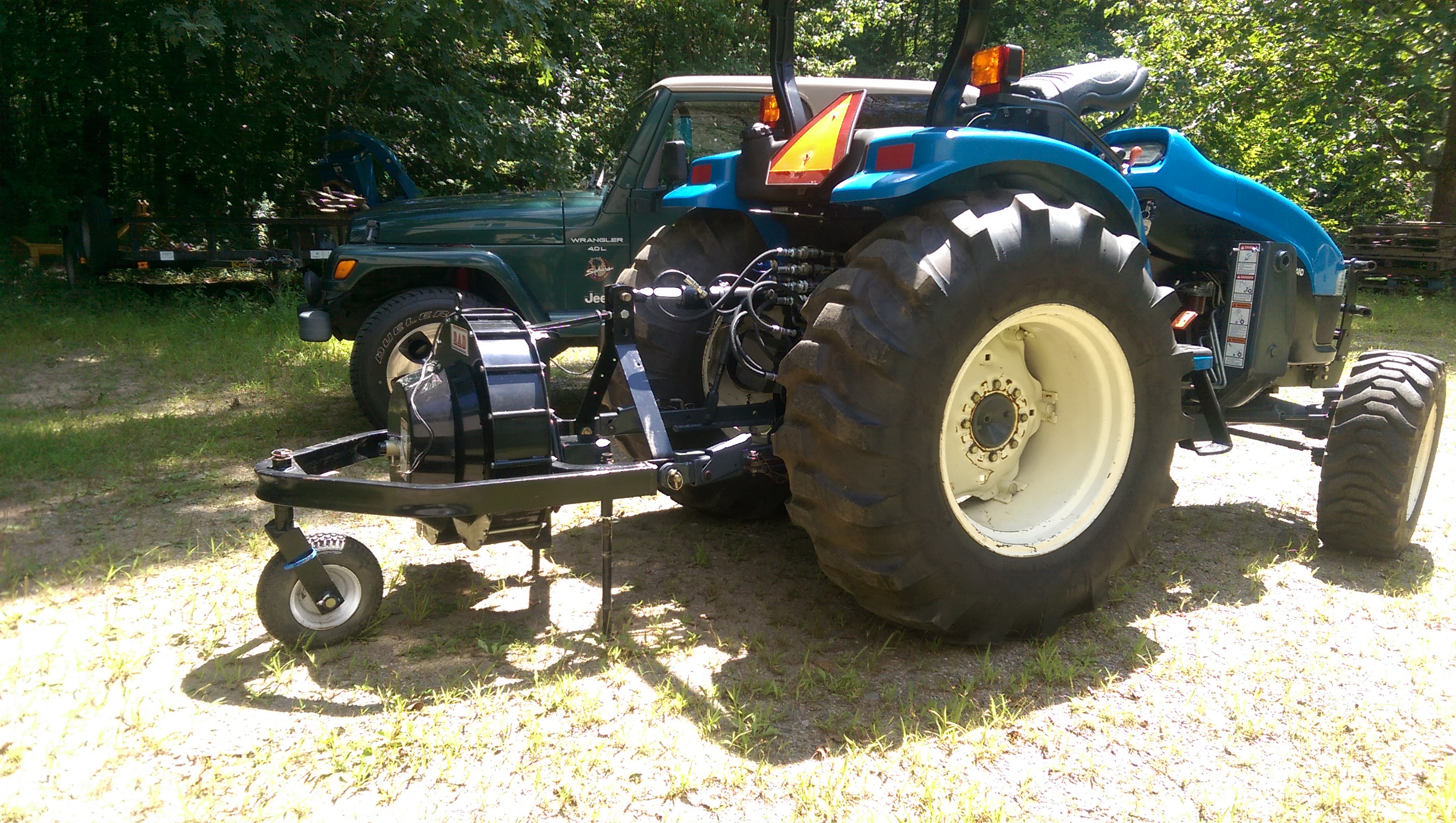

Also got to finally finish the actuators & the control box for the remote rotation & deflection shield for the Debris Blower (just in-time for fall leaves)... :thumbsup:
I now have 280 degrees of rotation & full deflection from the drivers seat.... bring on the leaves...

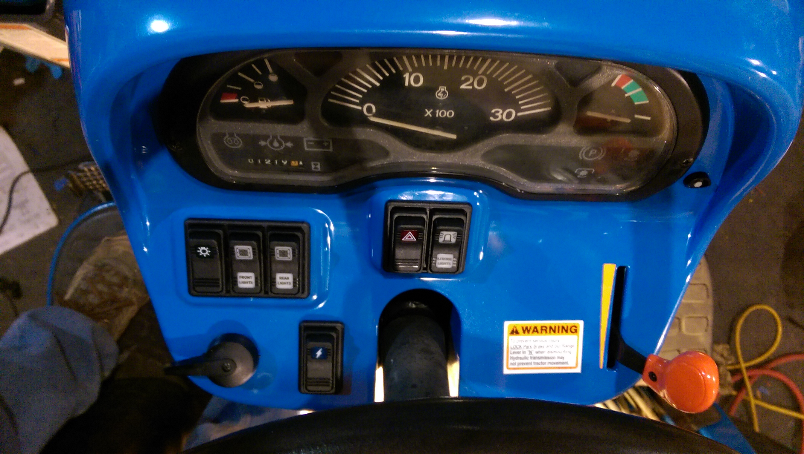

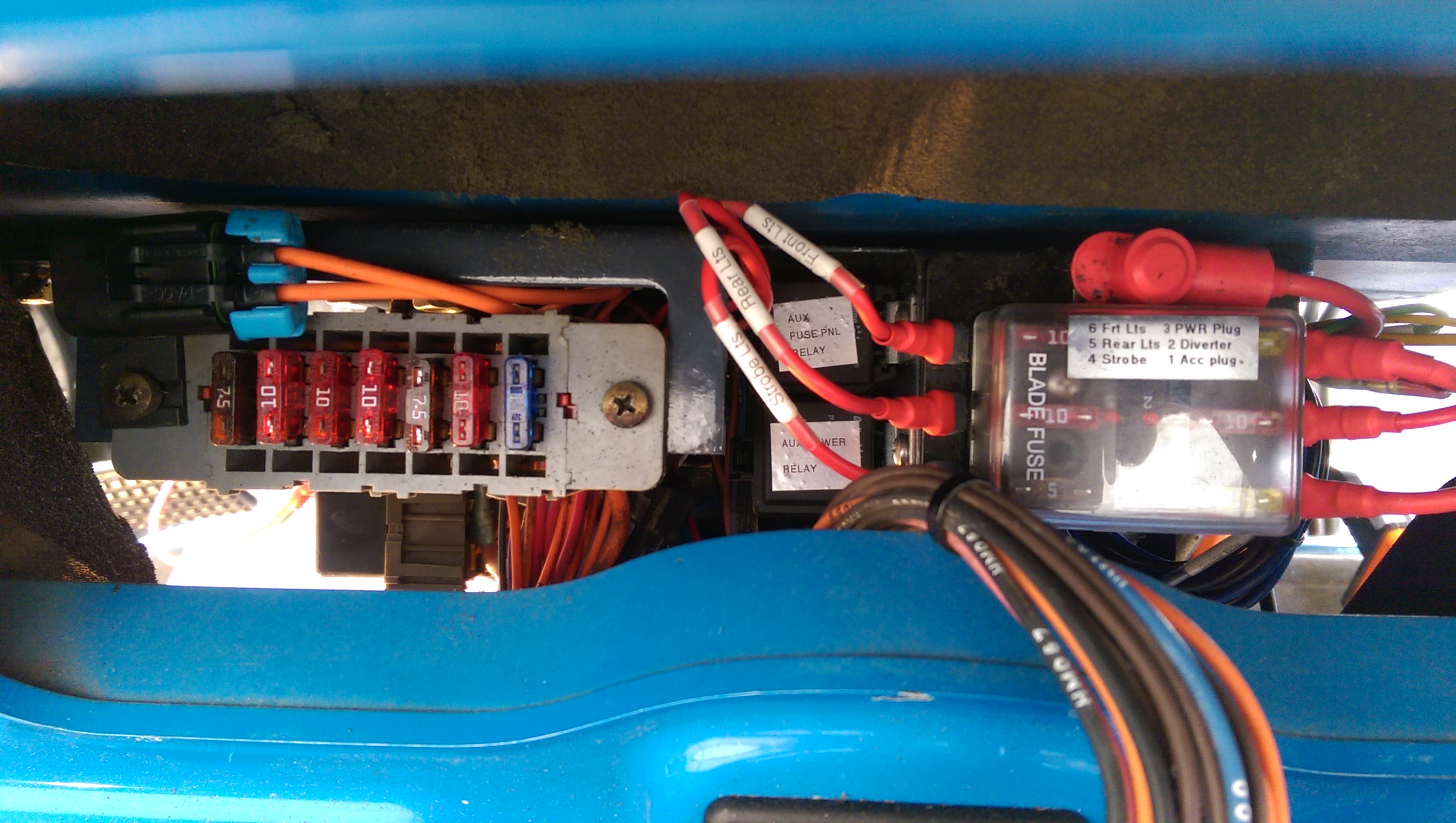

Thanks on the wiring comment... I try to keep everything as clean as possible & labeled for future troubleshooting (if needed)... I made the bracket to hold the new starter relay out in front of the new glow plug timer I just installed (I wanted the relays to be together). But I put the fuse protecting that circuit up near the Factory & my Auxiliary Fuse Blocks. The last pic is the new dash / switch layout I did during the resurrection of the TC...
