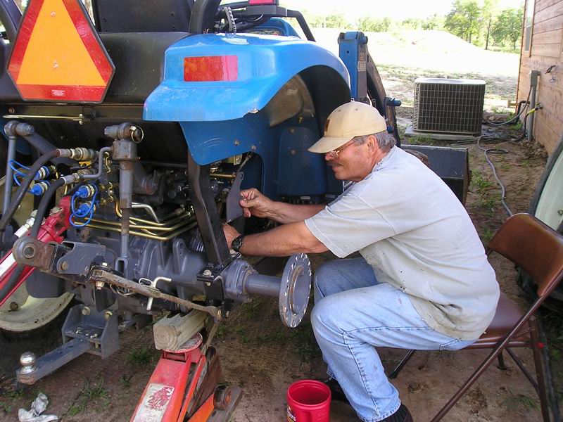

Yes, that plate is the swinging drawbar. It has pins on each side of it to hold it centered, but it can also have one pin removed and be positioned to one side or the other.
Is the disc a regular ball mount or a fork type ag hitch that goes over and under the drawbar? If it's a ball hitch, measure the holes and thickness of the drawbar and purchase or find a trailer ball in the right size for the disc. If it's an fork type hitch. You'll have to use a hitch pin based on the size of the hole in the disc's hitch. A regular Cat 1 or Cat 2 toplink pin may work.
I'm attaching a picture of me installing remote valves on my tractor. I've included it because you can see the drawbar and ball hitch I have. There are many configurations that will work. You just have to know what the hitch is on the disc.

Jim, I was glad to see the 6x6 wedged into your floor jack. Simpler than a stand and better outdoors anyway.
Jim
   / TC 40 draw bar #6
Jim
Yep! The jack has never failed me, but when I get under something, I realize it only has to fail once to be a catastrophe. I made sure that it would only drop about 2" if it failed. I had forgotten doing that until you pointed it out. That's been a few years and several pounds ago.:D
