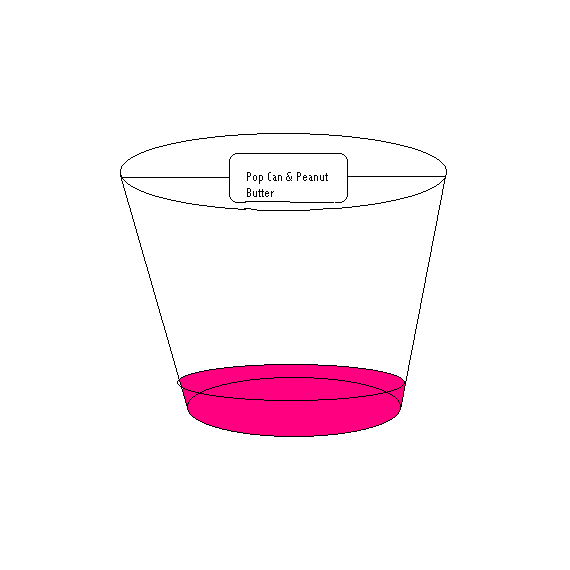

For the mouse problem try a continuous mouse trap. Get a pail and put a pop can on a wire axel and smear it with peanut butter. Place a couple of inches of RV antifreeze in the bottom and some wood or bricks beside the pail so the critters can get up to the rim. They will go after the peanut butter and then go swimming. I've tried everything to deal with mice and this works well and for long periods of time. Keep pets away. Although the RV antifreeze is not toxic it probably isn't good to ingest the stuff.
