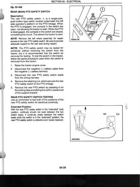

Can't tie in the PTO and the Brake safety switches together, but it is one of them. In light of the PTO light being on, I'd look at the PTO Safety Switch and associated linkage. Even though your lever may be in the "PTO off" position, if the linkage has come undone the linkage may be engaging the PTO. Attached is page 1 of troubleshooting the switch.
Edited:
The PTO safety switch is also responsible for sending current to the PTO indicator dash light.

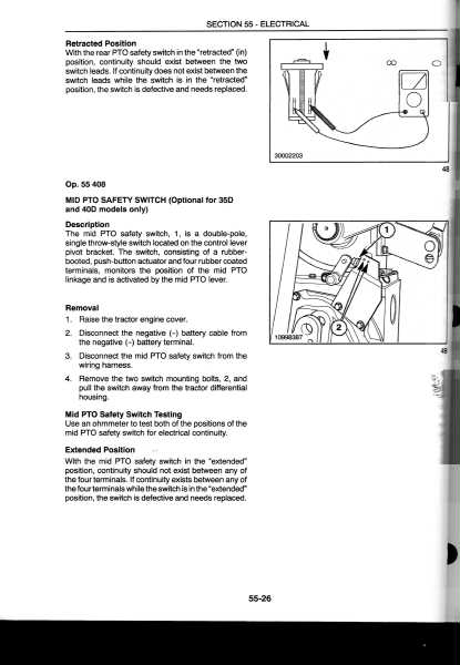

   / TC 35 Died last night... #5
Page 2. Also, diesels are not like gas engines. If it doesn't start when turning over, it won't do any good to try turning it over so much the battery dies.

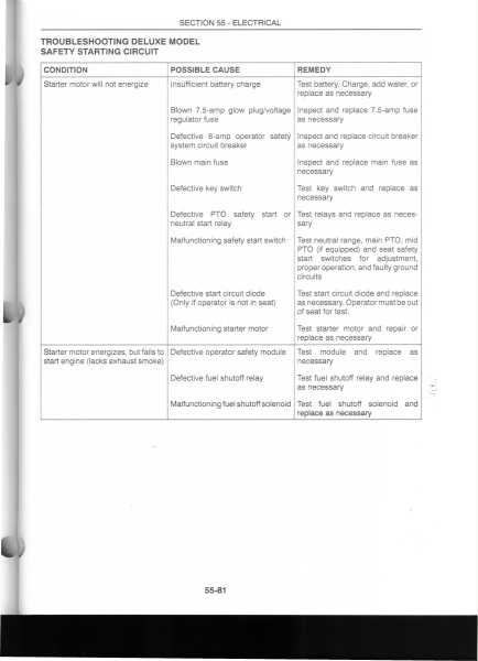

Been thinking more - with the PTO engaged the switch is open and the engine should not turn over. Are you still able to crank, or does the started not energize? The attached is the troubleshooting page for the deluxe safety starting circuit.
