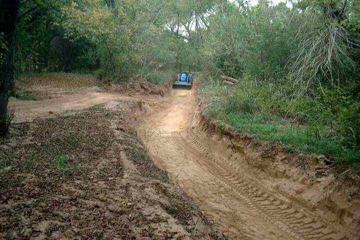

The swamp dried up last year and I cleaned out the creek so it drains into our soil conservation lake. Here is a photo when I was almost done. I now have yards and yards of sand in a pile. I made lot's of trips in and out of the creek over two weekends to get this done. /forums/images/graemlins/grin.gif
