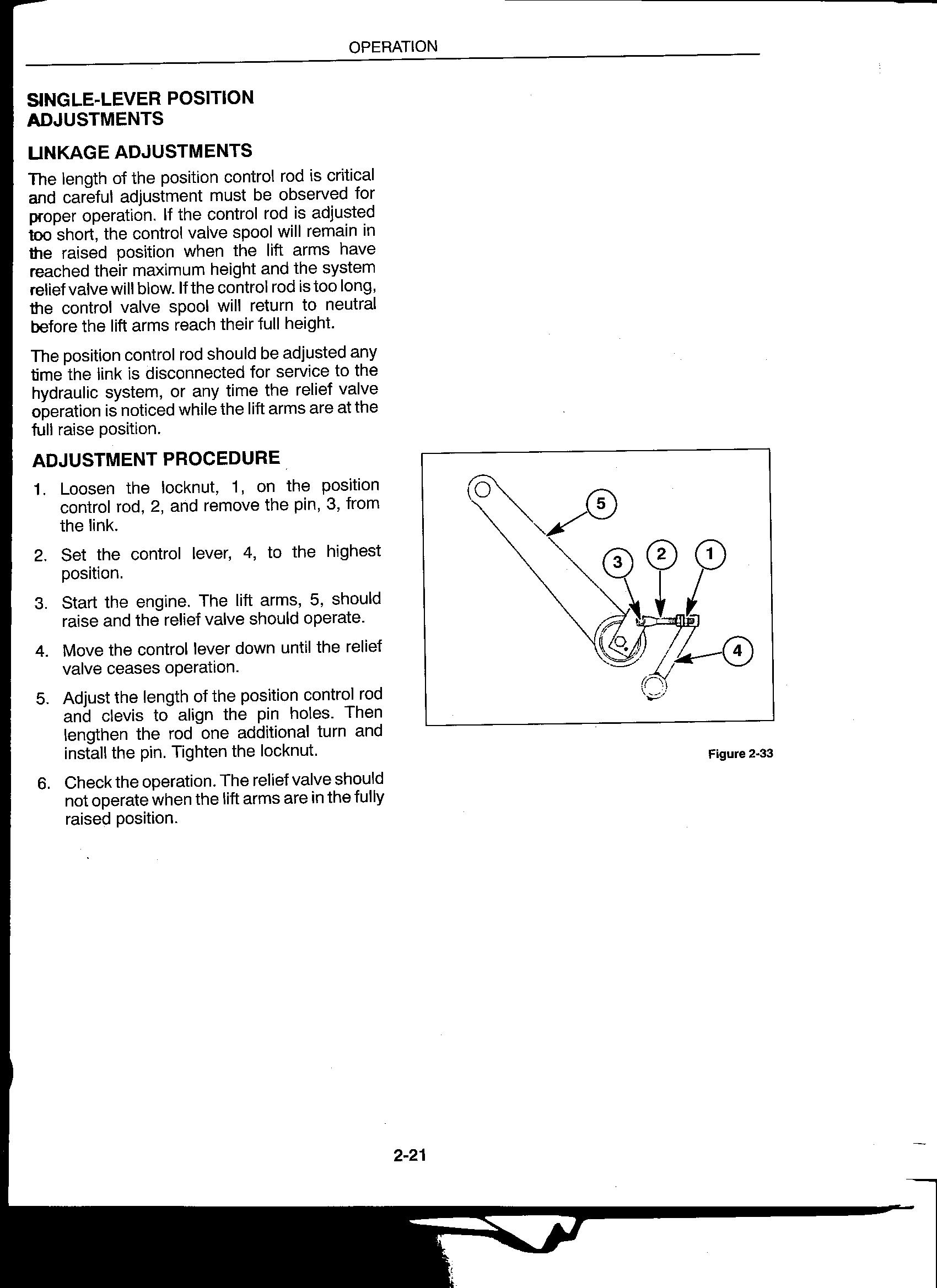

How is the best way to check suction side for air entering hydraulic system ? When I check dipstick it has small air bubbles any ideas? When I raise loader or 3 point it whines cold or warm it is hydrostatic drive

I may know what you're talking about. I have the same tractor. Check your 3pt hitch lever. Make sure it is not in the fully UP position. If you leave the 3pt hitch lever in the fully UP position the hydraulic motor will whine, and the system will heat up. Whining increases when cold. This situation will cause the hydraulics to whine continuously until you move the lever down and release whatever pressure is building up in the system from this condition. I have learned this over time operating this particular tractor. Whenever you hear the whine, reach down to your right and adjust this lever to break the tension. Always leave the 3pt hitch lever 90% of the way raised if you want to avoid damage/overheating to the system. I don't know why it does this, but that's what mine does and the symptoms sound similar to what you're talking about. Try that and see what happens.

Adjust the feed back linkage and it well stop that. Then you can take the lever all the way up.
/ Tc 33 da whining hydraulics #7
