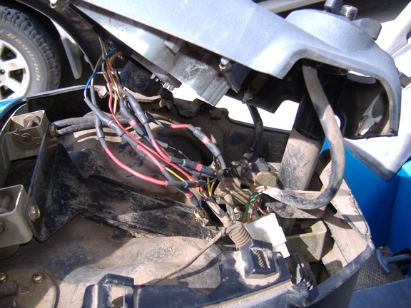

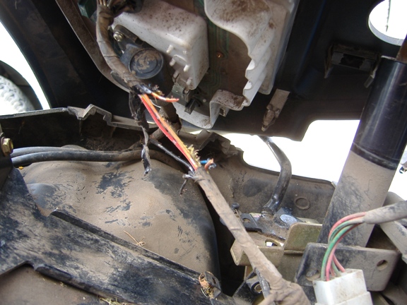

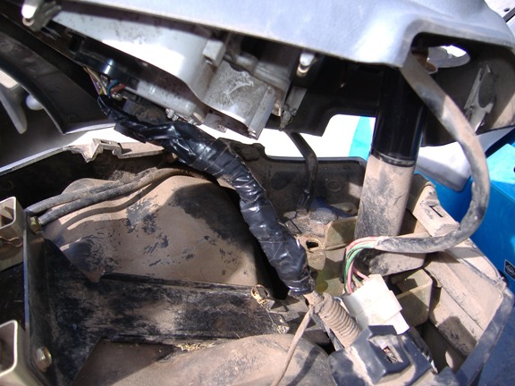

Found the problem.
Something had been nesting in my dash over the winter and had eaten the wiring going to the dash. I should have looked here first, because my fuel gage was registering really low, much lower than I had ever seen.
I spliced the wiring back together with butt connectors and covered the connections in heat shrink tubing, then electrical taped the bundle back together. Everything works good as new!
Right now, the tractor lives in a carport type of shelter, but maybe I need to look into some more secure storage...
We have been talking about a new garage for the cars, so the Tractor would get a place in the shop :)
