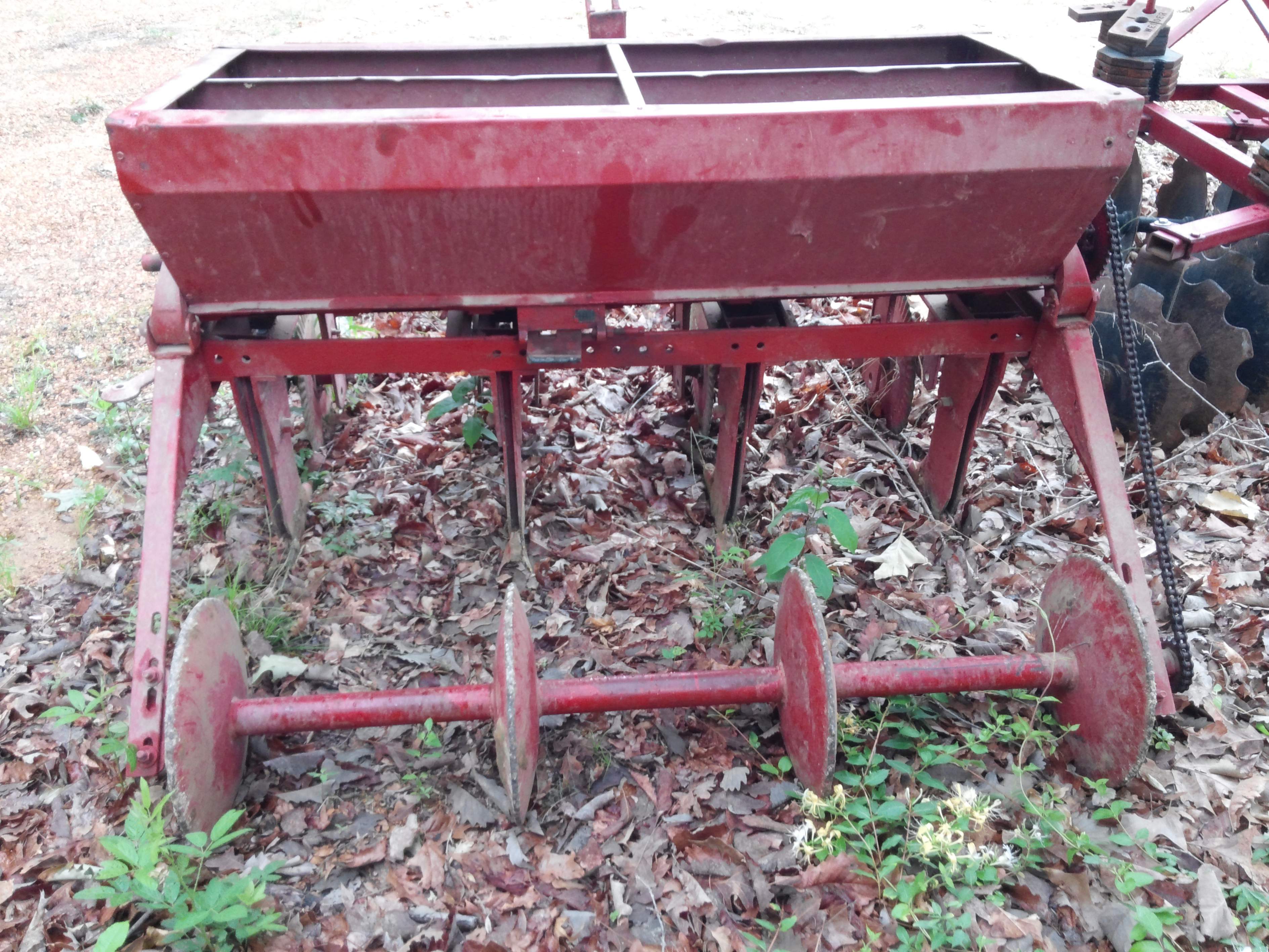

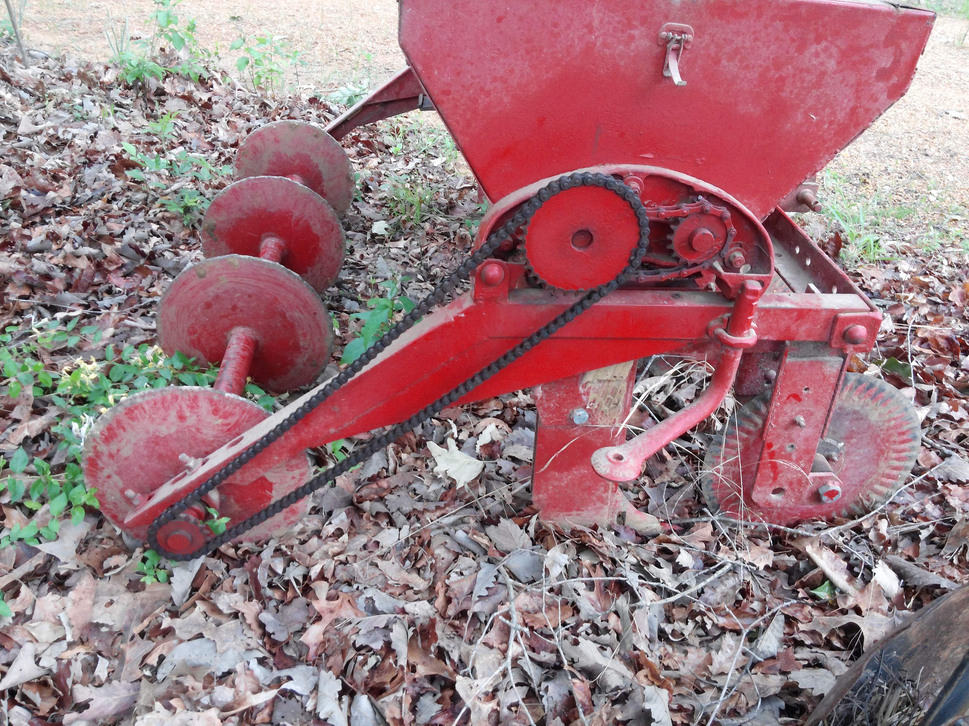

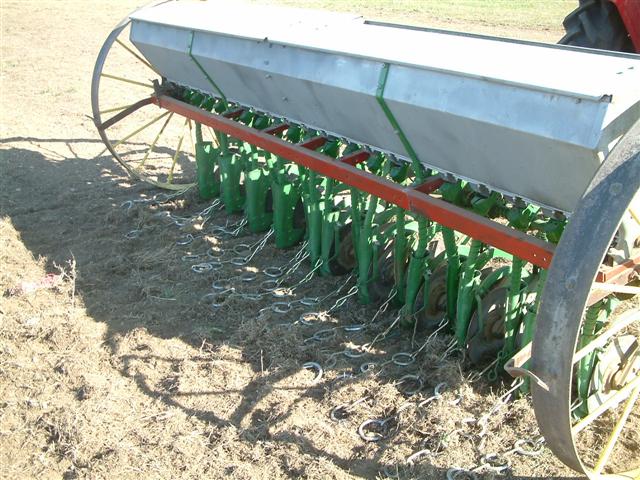

Got a nice Taylor Pasture Dream drill from CL and used it to plant sunflower/corn for Doves this weekend for the first time. It has some issues (really, it's only about 60 years old!) that I need some advice on.
1. The shut off mechanism that opens and closes the seed/fertilizer plate is worn at the pivot (probably egg shaped) and does not push the bar far enough to open and close the drop holes fully. It seems to be cast steel. Can it be machined out and sleeved to remove the 'slop'?
2. Should the seed boots be lower than the front coulters?
3. Considering replacing the mechanical shut off with a small Hydraulic cylinder to operate the seed gates. This keeps the seed/fertilizer from falling while the unit is raised while turning.
Anybody got one of these units and has to modify or repair? There are no parts available from Taylor.

Hello.....just picked up this thread while searching for Taylor or midland pasture dream....I have 3...1 Taylor and 2 midlands...my brother has a midland. There are some wear parts available...plow points and seals from RH machine...I worked with them to produce the seal which is the bat wing at the rear of the plow boot. I am working to get other parts to be developed for these machines. I can share information for set up for planting...colters... plow boots...shut off linkage

Don't own a Taylor. But I have restored several old Minneapolis Moline P3-6 grain drills (10 ft wide, 20 drops, single disc openers).
And I have replaced the rope-actuated trip mechanism that raises the openers with a double action hydraulic cylinder.
I like the simple design of your drill.
I should think that the coulters should be lower than the seed boots--just an opinion. I assume the coulters and/or boots are adjustable in height.
Don't see why your problem with the cast steel part can't be machined and sleeved unless there's a problem in removing the part so work can be done on it. Like I said, I don't have any experience with your type of drill. I have welded cast iron and steel successfully if that's any use to you.
Good luck.
