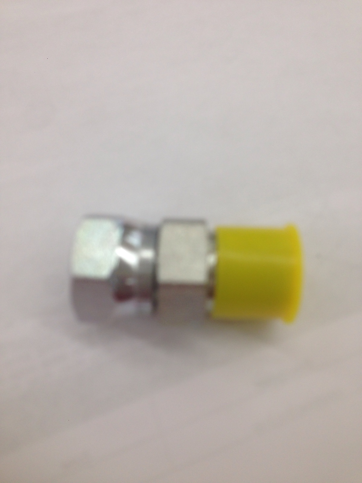

I would put your system together as you have it and then see if you have fine enough flow for your need. -8 lines are overkill. However, your cheapest solution is whatever size lines fits your fittings. You can buy in-line orifices to reduce flow. If its just an orifice and not an orifice/check valve, you only need one per cylinder. Orifices go in the hoses for the various cylinders, not the supply to the valve.
   / Talk to me about the rear remote hydraulic valve type...mx5200
^about the #8 yeah I agree it's overkill for that application but it would keep me from using a bunch of adapters, but maybe I should just adapt down. #8 stuff all costs more than #6 stuff or even #4 stuff.
I have never seen or used an inline orifice for a hose. I will have to investigate this thanks.
   / Talk to me about the rear remote hydraulic valve type...mx5200 #4
Whichever route is cheaper. Adapters cost a bunch. The orifice would be a male/female fitting probably. Size, don't know, but likely smaller than you think.

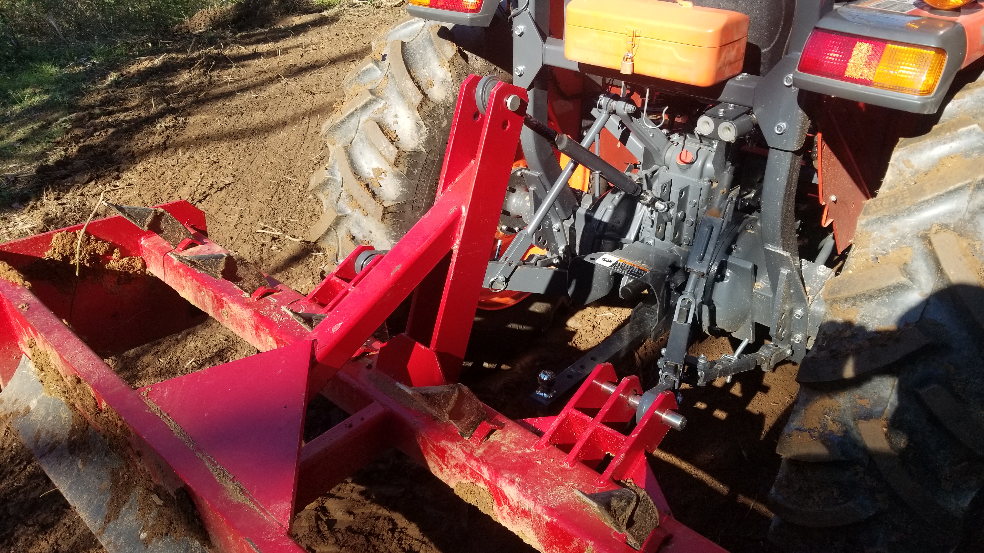

Your valve is not OEM. How about a picture or two.
I don't know why it wouldn't be oem. I ordered it from the dealer as an option when I bought the tractor and it had to be shipped from kubota.
That is the best pic i got right now.
Because you said the valve didn't return to center. The hook ups look oem.
