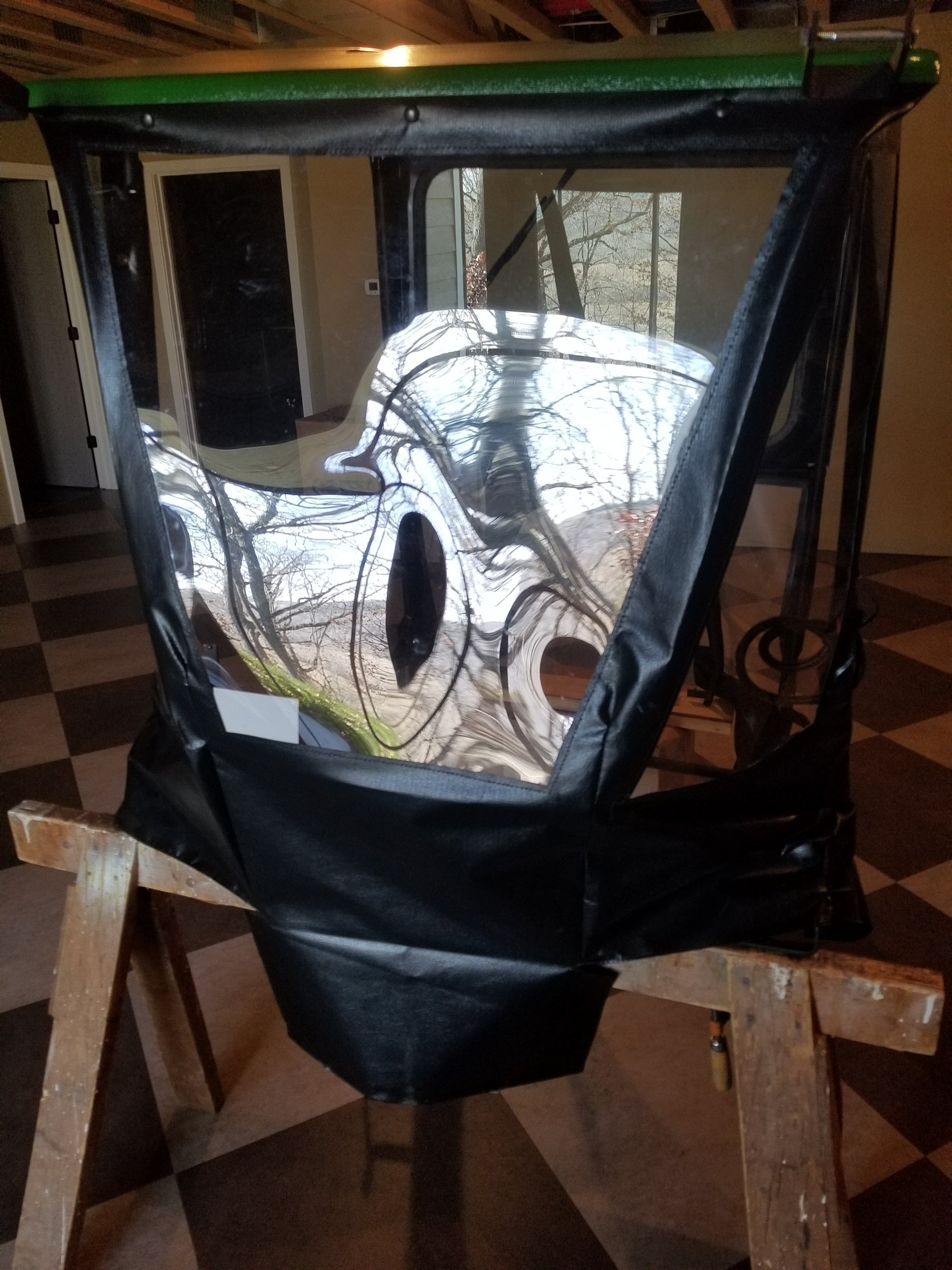

I have a Kubota L2501 w/FEL blade that I use to plow our driveway in the winter (south central Wisconsin), and although it usually takes less than an hour to do, I occasionally get a blast of wind driven snow that makes me long for some type of enclosure. I really like the looks of the original tractor cab enclosures, and they seem to review pretty good as well. My question is, does anyone have experience with one on an L-Series, and what (if anything) did you do to close up the area under the seat to the rear? If I do end up with one, I'd also most likely purchase and install an aftermarket heater, so I'd like to block the majority of the larger openings.

Hi, I'm surprised that nobody has responded to your question. I don't have a Kubota but I can't imagine the design varies too much from the OTC on my JD2520. I got it last year just before a sub-zero cold snap. Wow... should have done that years ago! My 2520 is comparable to your L2501; again, I'm guessing the cabs would be too. The rear cab section, behind the seat, is covered by the equivalent of 'leaving your shirttail out'. The vinyl just hangs below to just above the upper control arm.
Does it 'block' the opening? Pretty well actually. You won't feel a draft or wind. I'm not compelled to improve mine (I wouldn't know how to actually... a lot going on in that section of the tractor). Regarding the heater, I don't want one. In fact, when I bought, OTC had a promotion and gave me a 12V heater with the order. I didn't install and gave it to a friend for his cab'd Mule. Ease of installation/removal is important to me (kiss). I was comfortable with a coat on in that 10 day sub-zero snap. When the weather is in the 20's... the full winter coat is a bit much. Remember, you're putting an enclosure up against a machine that is rejecting heat as it chooches.
My cab is in the basement right now because I am about the fab a wooden lift beam tool before re-installing it this year. TTWT has a few videos showing his installation method... pretty wonky. I have an open post in the "Snow Blowing" section here asking for installation ideas; 2 responses so far. One lifts it off then stores up to his garage rafters and the other takes it all apart. I really want to leave it together (again, ease of install is important to me.) I just finished installing a box rail to the ceiling of my shop. I bought a single 'truck' in it to carry a simple deer hoist pully system. The plan is to park the tractor centered under the rail, snap the lift beam to the cab, attach to the hoist, lift cab, slide over the tractor from the rear, and lower down. I'll post results and pics by week's end probably. Hope this helps!

Thank you! That's quite helpful as haven't been able to find a pic of the rear of the cabs to see how far down they came. Luckily, things have been pretty mild and snow free so far this year, but the more the temperature drops the more I think I should've already purchased and installed one of these by now!
