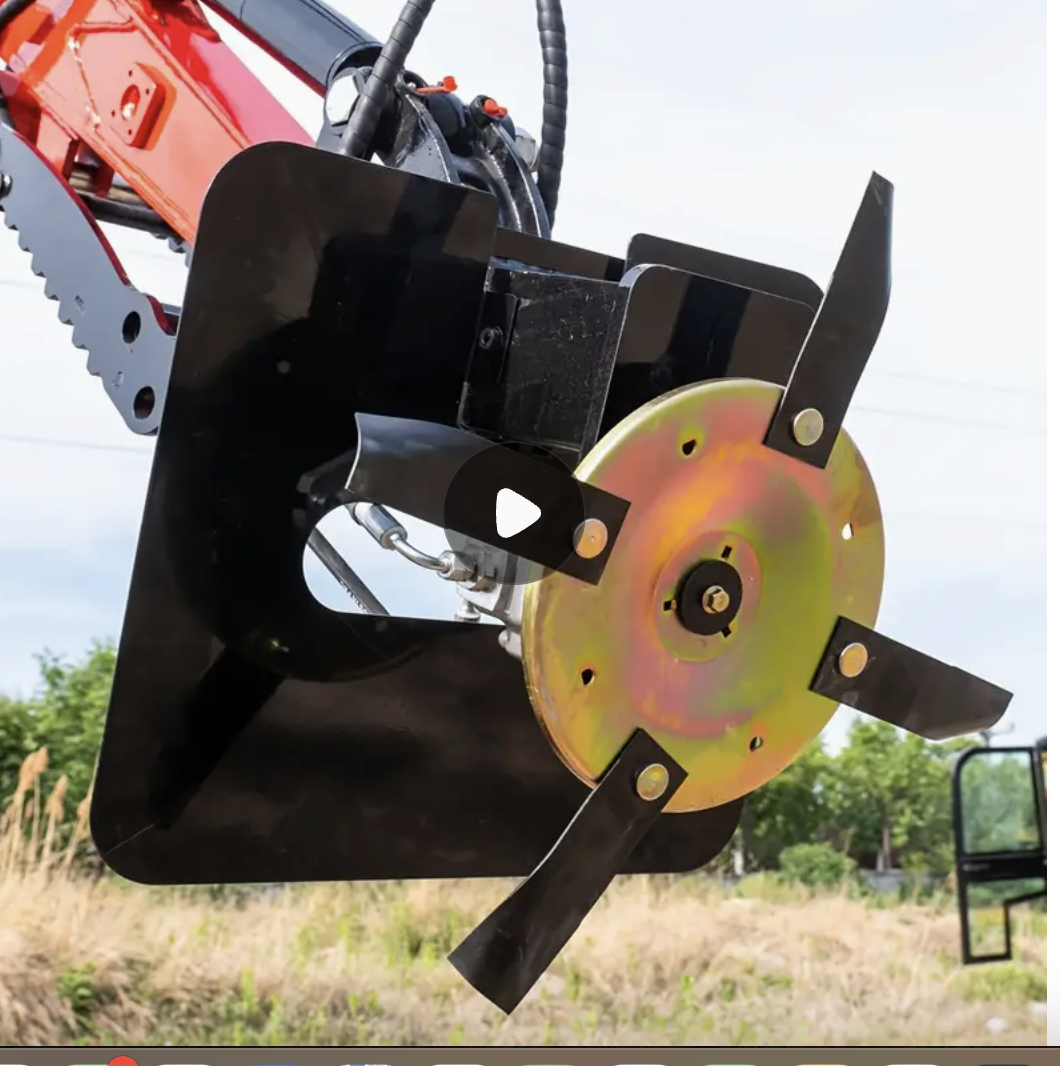

Oh, I also want to get one of those cheaper brush cutters like this. I suppose the 2 ton has a more capable hydraulic pump.
For your safety, please don't. Get something that offers more protection to the operator than that, even if it costs more money and you have to wait a bit.
That thing will throw stuff all over you, either hitting you, or breaking the front glass if you get a cabbed mini ex, along with the risk of breaking a blade and who knows where it can land.

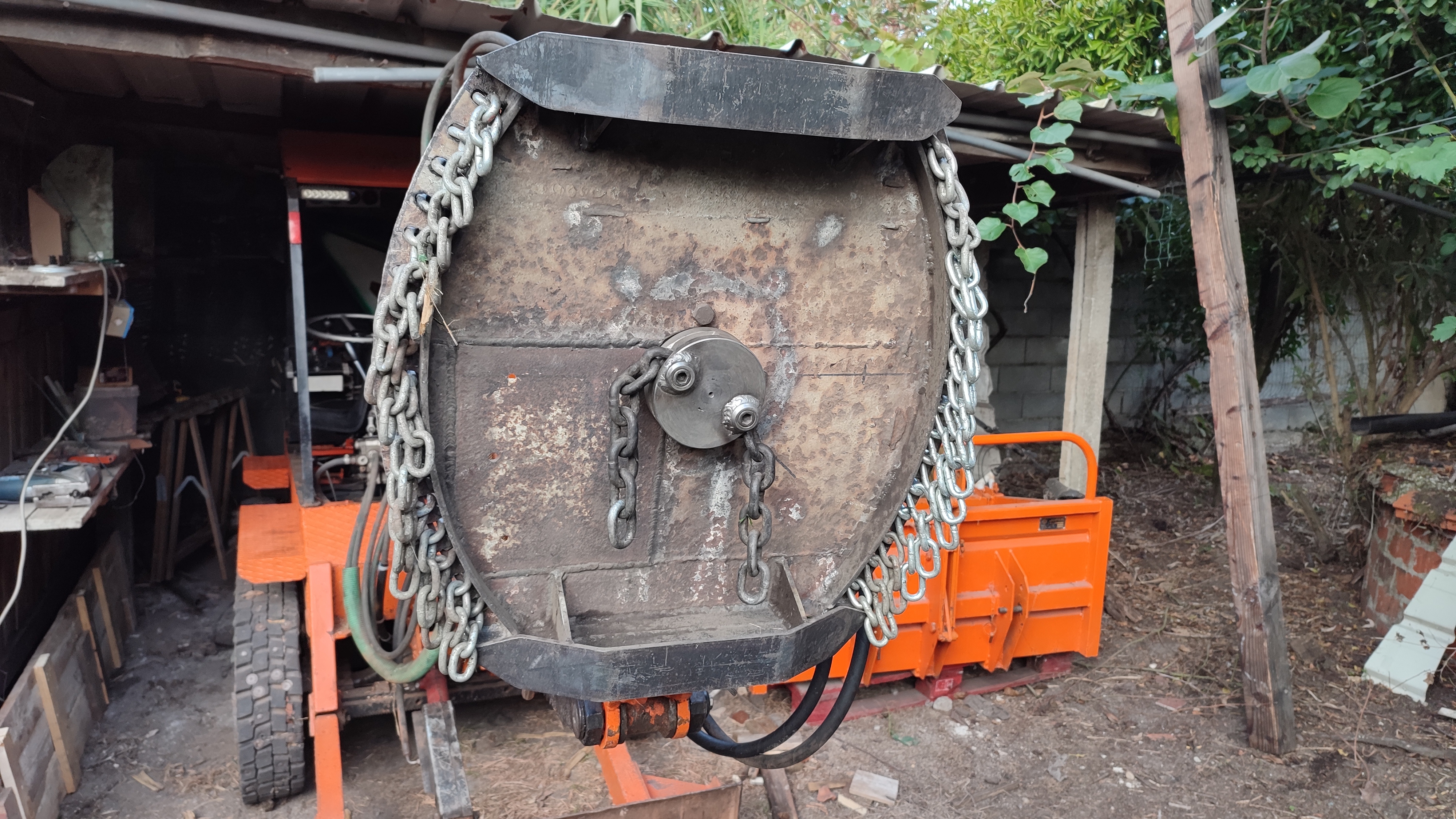

I build this one for my homemade excavator some time ago. Offers much better protection to the operator.
As far as excavator size, I would go for the 2 ton for sure. More weight, much more stable, more capable. Usually offers better and smoother controls.
   / Talk me into a $10k 2 ton vs A $5000 1 ton Chinese Mini!
#9
View attachment 4025181 View attachment 4025182
Yeah, I was going to add some guards on the cutter and make a 3/8 plexiglass screen I can attach to the canopy when in use.
