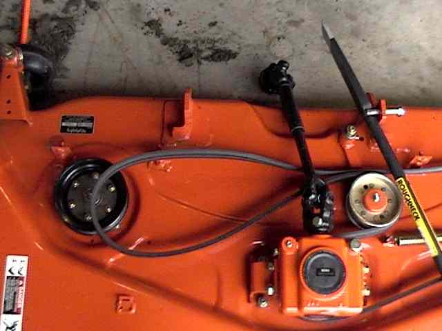

The first time I took the belt loose prior to storing the mower for the winter I had a heck of a time getting it off. Now it only takes about 30 seconds to do it.
All you need is a long pry bar or sturdy pipe and a 3 to 4 inch 3/8 bolt. slide the bolt in, align the pry bar and give it a yank.

Just slip the belt over the pulley and your done. This was on a the 54" deck for my BX1500, but I think it would work for all the BX models.

I cannot quite see how you are getting the belt off in your pictures. Are you pressing down on the belt with your prybar? Thanks, I am getting ready to store my MMM for the next 6 or 7 months and want to take the pressure off of the belt.

AKFord, what the Kid is doing is placing the pry bar on the SIDE of the pulley touching the belt itself. He then (looking at picture #1) is pulling the pry bar to the left making the spring get tighter but releasing pressure on the far left pulley, (picture #2). This allows the belt to come off the far left pulley with ease. I used to release the spring from the attaching hooks and pray that it didn't bounce loose and take a few of my teeth with it. I tried AKFord's way and it is much much easier. For what it's worth my belt (although starting to show wear and tear) is 16 years old. I've always released pressure on it during the winter storage season. Good luck! /forums/images/graemlins/laugh.gif
   / Taking the belt off a BX MMM #9
Thanks SRS, I just went and did it! It worked, the MMM is clean and ready for the winter. I appreciate your help.
