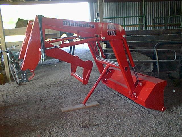

For those wondering about removing the FEL on a 2615, it takes a little over 3 min to hook up. This includes walking to the barn. It takes my wife about 4 minutes. A little less time to unhook it. The pic shows the FEL freestanding in the barn.

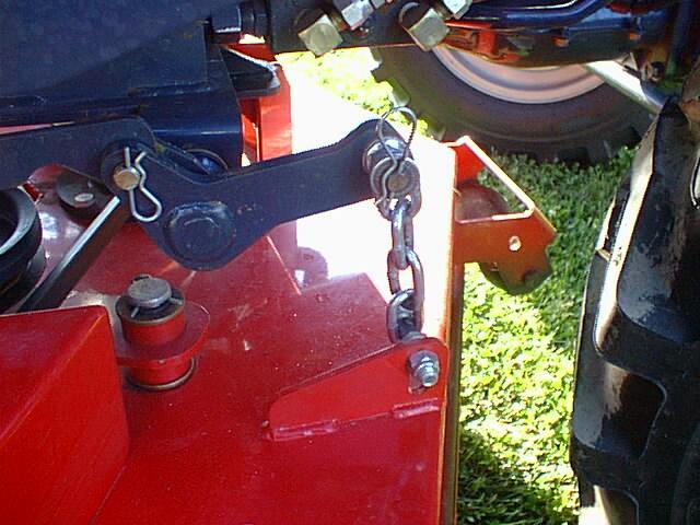

The MMM can be removed in about 5 minutes if the FEL is on. If not, it will take about 6. The deck can't be easily remove unless the front end is raised slightly. Use the FEL for this or drive up on some 4x4's. Logical safety precautions are recommended. Modifying the 4 chain bolts with quick strip pins and some washers saves a considerable amount of time. Just like the FEL, my wife can do all of this by herself easily.

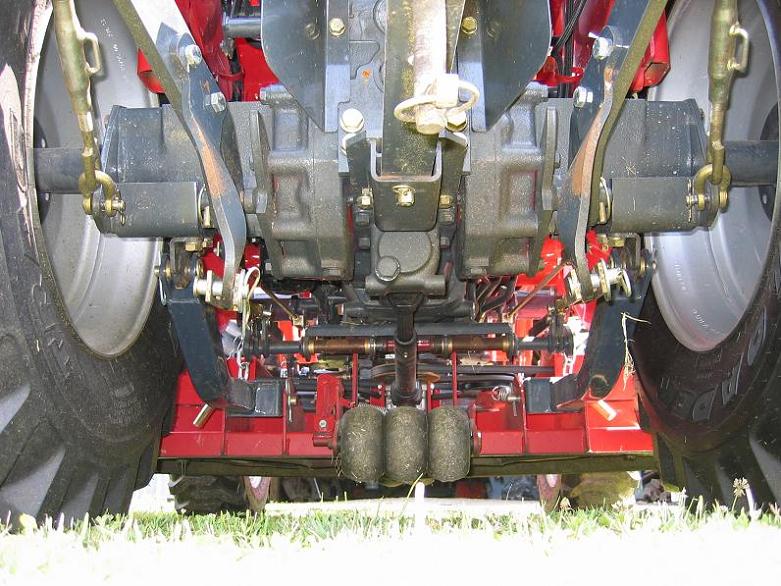

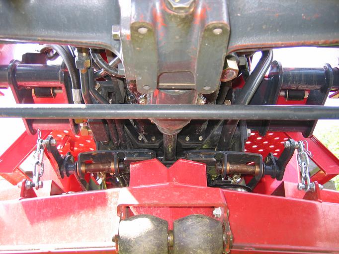

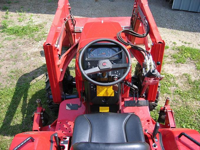

Trash, I'd like to see some other pics of your red unit. Espcially the operator's station and the underside.
Do you have any pics like this lying 'round?

Pilot's seat!

Rear U-body

Front U-body
