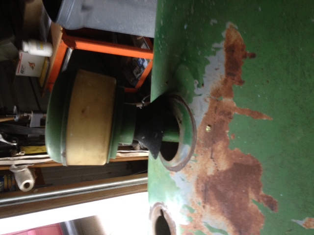

I got the hood off my gas 3010, but had to take the air cleaner stack off with it. How does the top portion of the stack separate from the rest of the air cleaner ( or is mine just stuck by age). See attached photo.

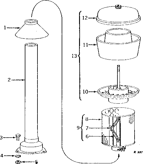

One just takes a dead-blow mallet or hammer and tap parts key #10 off of parts key #2

Tx Jim, thanks for the help. The hood is off and ready for sandblasting, and also can now get to the selective control unit.
