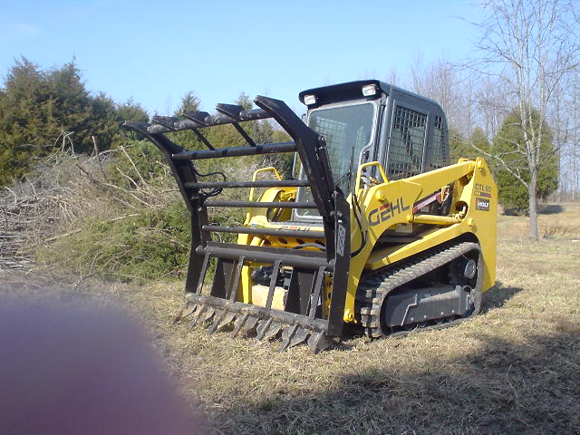

Takeuchi makes the tracked loader for Gehl and they are virtually identical except for paint. Mine is the Gehl version of the smaller model and it appears to be meticulously designed and assembled. Welds are beautiful. All wiring and hoses are neatly routed. I can't imagine any of the other brands being more carefully made.
One improvement Tak. made that wasn't available on Gehl's was their glass door on the cab slides up overhead instead of swinging out like a normal door. With the Gehl, you can't open the door unless the loader is all the way down. That's been a pain like when you load a machine on a truck, you can't get out to slide the machine out of the bucket. Otherwise, I'd recommend either.
John
