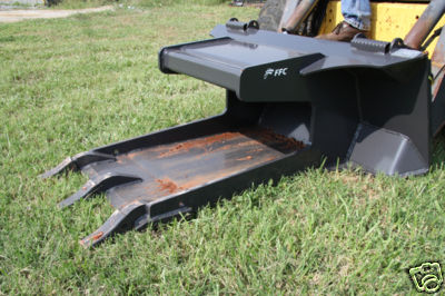

Does anyone have experience taking out cement sidewalks with a CUT? A friend purchased several lots around his home which need the old sidewalks removed. I have been ripping along the edge with a subsoiler and he has been using his old case 400 with loader to pop them out from the end. This method is progressing rather slowly and there is a lot of sidewalk to take out.

If you had one of these, it would be very easy. Just run it under the cement, lift, and take it away. That is what it was made for.

A large skidloader.
Some of those old sidewalks can be 6" + thick. The skidloader can also bust up larger pieces to more manageable weights. If theres rebar then add a torch or bolt cutters if thin enough.

Working with a buddy of mine, we lifted the sidewalk up a few inches off the ground and the broke it with a sledgehammer. We went back and used the broken pieces to make a bric brac retaining wall. It stacks real well and the wall has a nice rustic look to it.
