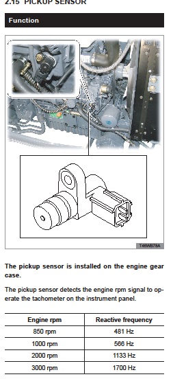

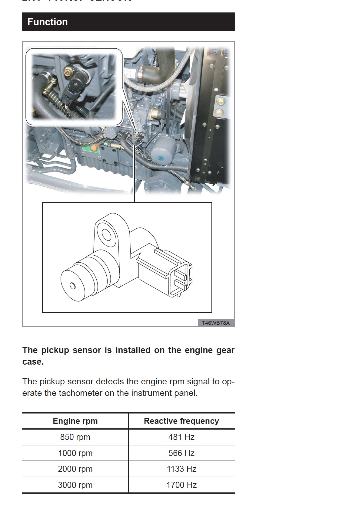

Check under the hood and make sure the tach sensor is connected. Still not sure what type of DK you have but it should look something like this

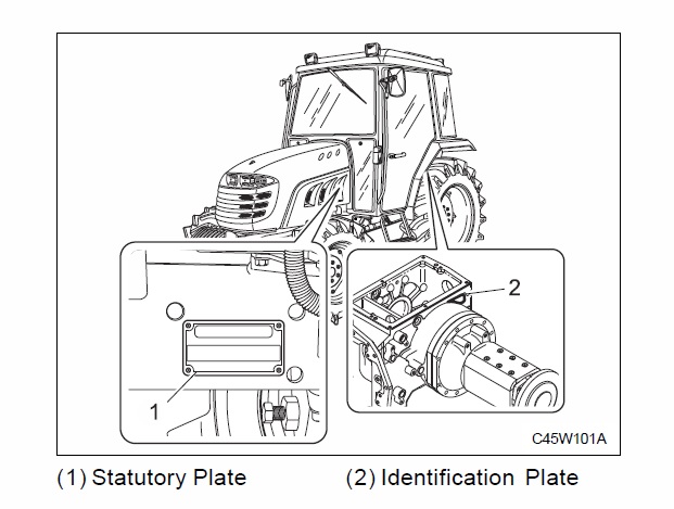

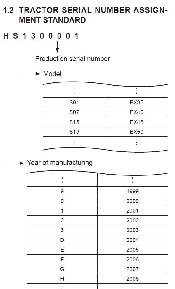

Also, you can decode the precise model and year from the serial number.

Thanks for the detailed response, Scott. I'm pretty sure I have a straight up DK35 I can't find anything in the paperwork I was given to indicate otherwise. Where is the serial number located on the tractor? I poked around and it didn't jump out at me. My tractor doesn't seem to have the tach sensor that is in the photo either. I'll check out MIE's website and see if I can find it in the schematics
